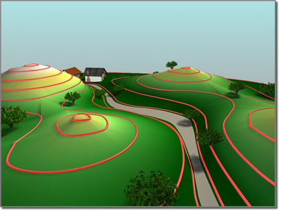

To produce a terrain, you select editable splines representing elevation contours and then click Terrain, whereupon 3ds Max generates a mesh surface over the contours. You can also create a "terraced" representation of the terrain object so that each level of contour data is a step, resembling traditional study models of land forms.
Using contours to build a terrain:
Inset left: The contours
Inset right: The terrain object
Main: Terrain object used as the basis of a landscape
You can import an AutoCAD drawing file to use as contour data. When you do so, 3ds Max names each object based on the AutoCAD object's layer, color, or object type, appending a number to each name. For example, an AutoCAD object on the layer BASE becomes an object named BASE.01. See Importing DWG Files for more information.
After you import or create the contour data, select the objects, and click the Terrain button, 3ds Max creates a new triangulated mesh object based on the contour data. The name of the first selected spline becomes the name of the terrain object. Other splines in the selection are treated according to the previously set Reference, Move, Copy, or Instance selection in the Pick Operand rollout, described below.
Keep in mind that the Terrain object can use any spline objects as operands, whether they are horizontal splines or not. Though the most common scenario is when sets of elevational contours are used to create terrain forms, it is possible to append or refine Terrain objects by using non-horizontal splines.

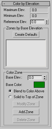

Color by Elevation rollout
Maximum Elev.
Displays the maximum elevation in the Z axis of the terrain object. 3ds Max derives this data from the contour data.
Minimum Elev.
Displays the minimum elevation in the Z axis of the terrain object. 3ds Max derives this data from the contour data.
Reference Elev.
This is the reference elevation, or datum, that 3ds Max uses as a guide for assigning colors to zones of elevation. After entering a reference elevation, click the Create Defaults button. 3ds Max treats elevations above the reference elevation as solid land and those below the reference elevation as water.
If you enter a value no greater than the minimum elevation in the object, 3ds Max divides the range between the reference and minimum elevations into five color zones: dark green, light green, yellow, purple, and light gray.
If you enter a value between the minimum and maximum elevations, 3ds Max creates six color zones. Two zones (dark blue and light blue) are used for elevations below the reference elevation. These are considered to be under water. One zone (dark yellow) is used for a narrow range around the reference elevation. Three zones (dark green, light green, light yellow) are used for elevations above the reference elevation.
If you enter a value at or above the maximum elevation, 3ds Max divides the range between the minimum and reference elevations into three zones (dark blue, medium blue, light blue).
Zones by Base Elevation group
Create Defaults
Creates elevation zones. 3ds Max lists the elevation at the bottom of each zone, referenced to the datum (the reference elevation). 3ds Max applies the color of the zone at the base elevation. Whether the colors blend between zones depends on your choice of the Blend to Color Above or Solid to Top of Zone option.
Color Zone group
The items in this group box assign colors to elevation zones. For example, you might want to change levels of blue to indicate the depth for water. Your changes in the Color Zone area don't affect the terrain object until you click the Modify Zone or Add Zone button.
Base Elev
This is the base elevation of a zone to which you assign color. After entering a value, click Add Zone to display the elevation in the list under Create Defaults.
Base Color
Click the color swatch to change the color of the zone.
  • Blend to Color Above Blends the color of the current zone to the color of the zone above it.
  • Solid to Top of Zone Makes a solid color at the top of the zone without blending to the color of the zone above it.
Modify Zone
Modifies selected options of a zone.
Add Zone
Adds values and selected options for a new zone.
Delete Zone
Deletes a selected zone.
