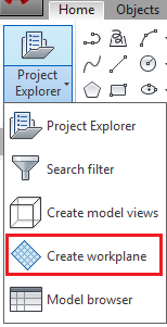

The command for workplane creation is accessible from the Workplanes pane of the Project Explorer and from the Home ribbon tab.
A dialog box appears, allowing you to select the desired creation method.

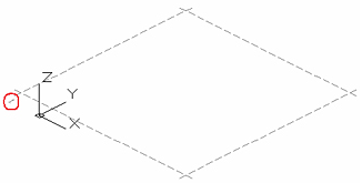

Select a point where the workplane will be positioned and enter a name for the workplane.
The workplane is positioned in the XOY plane and the name is displayed next to the lines that define it and in the Project Explorer.

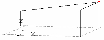

The plane is defined by any three selected points. The new workplane is not dependent on the position and orientation of the UCS.
Tip: You can create help-lines in order to precisely define the work plane.
For example, define three points as in the following picture and name the workplane.

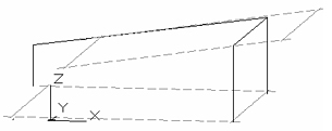

The new workplane is created.
