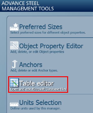

  3. Start the Management Tools.

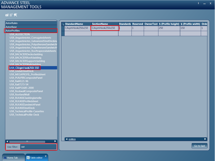

  4. Use the Table editor to open the AstorProfiles database and follow the procedure as follows:
    • Search for the ProfileMasterTable table using the filter. In this table you can find the new user section.
    • In the ProfileMasterTable, from the TypeNameText column copy the internal name assigned to the user section (Usr CAsymmetric-Hook).
      In the same database AstorProfiles search for the definition table of the profile. The name of the table is similar with the internal name of the section USR_CAsymmetric-Hook. ". From the Section name column copy the section name CAsymHook250x150.

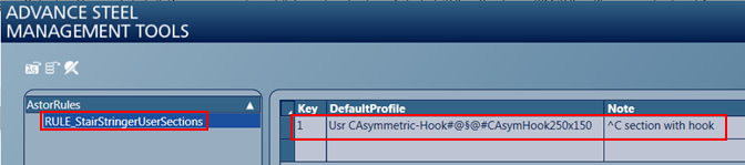

  5. In the AstorRules database search for the RULE_StairStringerUserSections table using the filter.
  6. Add a new line in the "RULE_StairStringerUserSections" table.
    • Fill a unique number in the Key column.
    • The DefaultProfile column must be filled like: "Usr CAsymmetric-Hook#@§@#CAsymHook250x150" where "Usr CAsymmetric-Hook" is the internal name of the section from the "ProfileMasterTable" table from the AstorProfiles database; "#@§@#" is a unique separator which is used to add any new section; "CAsymHook250x150" is the section name from the definition table of the profile "USR_ CAsymmetric-Hook" from the AstorProfiles database.
    • The Note column is completed optionally; for example it can contain information about the section type. This information does not appear in the "Stair" joint.

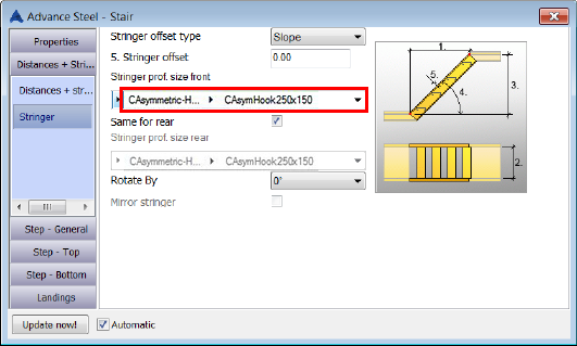

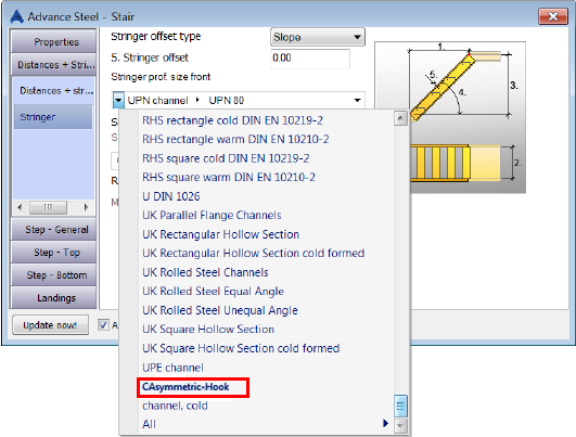

Create a joint Stair in Advance Steel and from its properties choose the previously defined user section.
