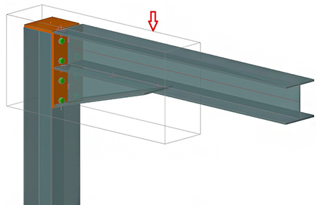

Joints consist of several elements such as plates, stiffeners, beams, bolts and welds held together and represented inside a bounding box (connection object).
These sets parameters are stored in the connection object (the gray box).

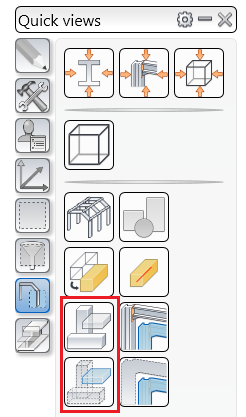

To display the box, click (All visible) command from the Quick views tool palette, which displays all hidden objects.

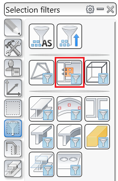

To select all joint boxes, click (Joint boxes) from the Selection filters tool palette.

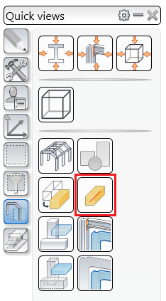

After the selection is made, the Selected object off () and Show only selected objects () can be used to turn their visibility on or off.
Also to turn their visibility on, without affecting the other objects in the model, the Standard presentation can be used.
