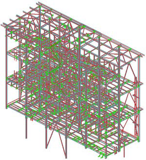

If you have a model where all treatments are displayed like in the picture below:

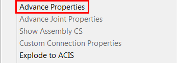

  2. Right click and select Advance Properties from the context menu.

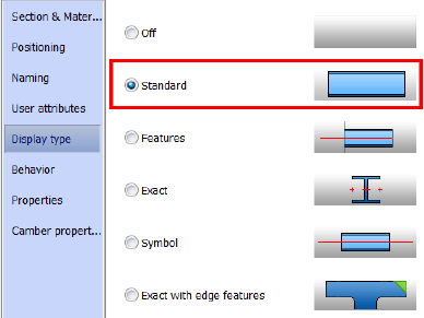

  3. In the Beam properties dialog box, Display type category, select Standard.

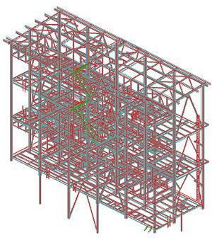

You will get the following result:
