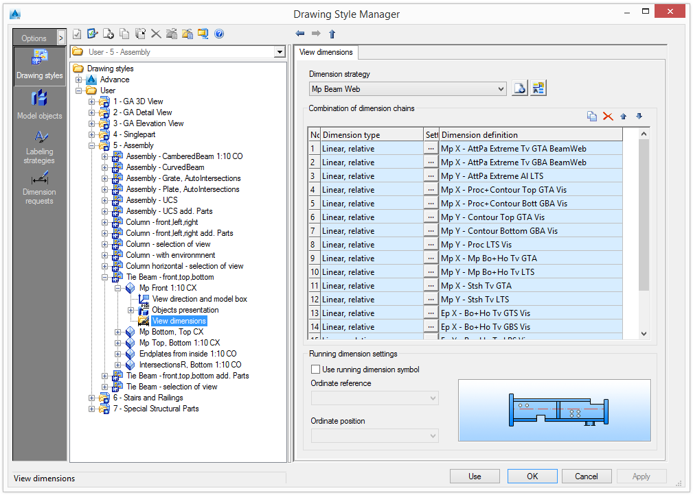

Set the View Dimension Style
A view dimension style contains the dimension types created by the selected view. Each view can be dimensioned differently.
The list of dimension types is located on the View dimension tab and you can access it:
  • From the tree panel, by selecting the View dimension branch.
or
  • From the View definition tab, in the View dimension area, by clicking (Set).
All dimension chains that are created by the selected view are listed in the table. Running dimension settings can be customized along with the settings for the dimension chains.
The properties of each dimension chain definition can be configured in the Dimension request tab. You can access the Dimension request tab by double-clicking in the list or from the tree panel, by selecting the dimension definition.
Attention: All views containing modified dimension chain definitions are also changed.

The Combination of dimension chains area displays all the dimensions chains created by the selected view.
A dimension chain is modified directly in the table by selecting the dimension type and the dimension definition from the list.
Only definitions that have been created by Advance in the Dimension request category can be selected. The dimension definition settings are accessible by double-clicking a row in the table. Their properties are configured as described in Dimension Request.
All the views containing the modified dimension chain are also changed.

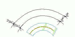

Arc angle, absolute
Arc angle, absolute from end
Arc angle, relative
Arc angle, relative and absolute
Arc angle, relative and absolute from end

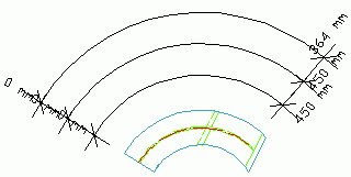

Arc length, absolute
Arc length, absolute from end
Arc length, relative
Arc length, relative and absolute

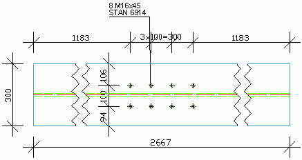

Linear, absolute
Linear, relative
Linear, relative and absolute
Linear, relative and absolute from end

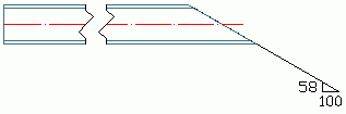

Slope triangle
Slope triangle, horizontal
Displays the slope relative to the X direction.

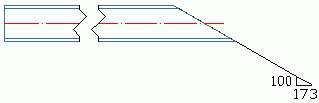

Slope triangle, smallest edge
Displays the slope relative to the smallest side of the triangle.

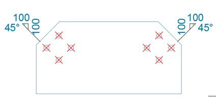

Note: The sloped triangle dimension will always be created towards the outside of the object for symmetrical hole patterns:

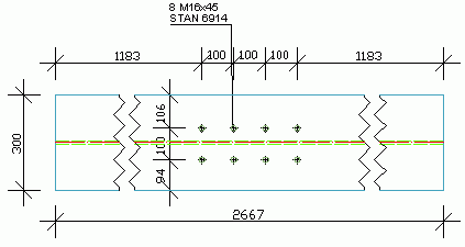

  • Combine equal distances using Group equal distances.
Equal distances not grouped
Equal distances grouped

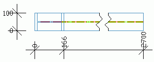

Customize the running dimension settings
  • Check Use running dimension symbol.
Setting the ordinate reference and position defines the symbol placement.
Ordinate reference
Left side of the main assembly.
Left side of the total assembly.
Right side of the main assembly.
Right side of the total assembly.
Ordinate position Description
Above The symbol is placed above.
Below The symbol is placed below.
