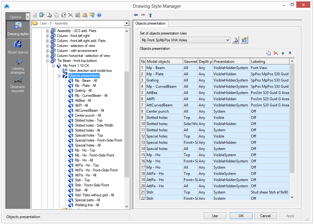

Modify a set of object presentation rules
Modifications of the object presentation rules are performed using the four buttons on the right side of the "Objects presentation" area. All the views containing the modified set of object presentation rules are also changed.
Button | Function |
Add a new object presentation rule. |
Delete an object presentation rule. |
A new object presentation rule is created using an existing rule.
- Select an object presentation rule to use as a template.
- Click
(Add).
The new rule is added to the set of object presentation rules.
- Select an object presentation rule to delete.
- Click
(Delete) to delete the rule from the list.
Change the order of the list
The order of the object presentation rule list is modified with the two arrow buttons,
and
In the assignment of the model object, a certain order must be maintained to achieve the required results. Generally, the list is processed from top to bottom. If a setting can be applied, it will be used. Otherwise, it will move to the next entry.

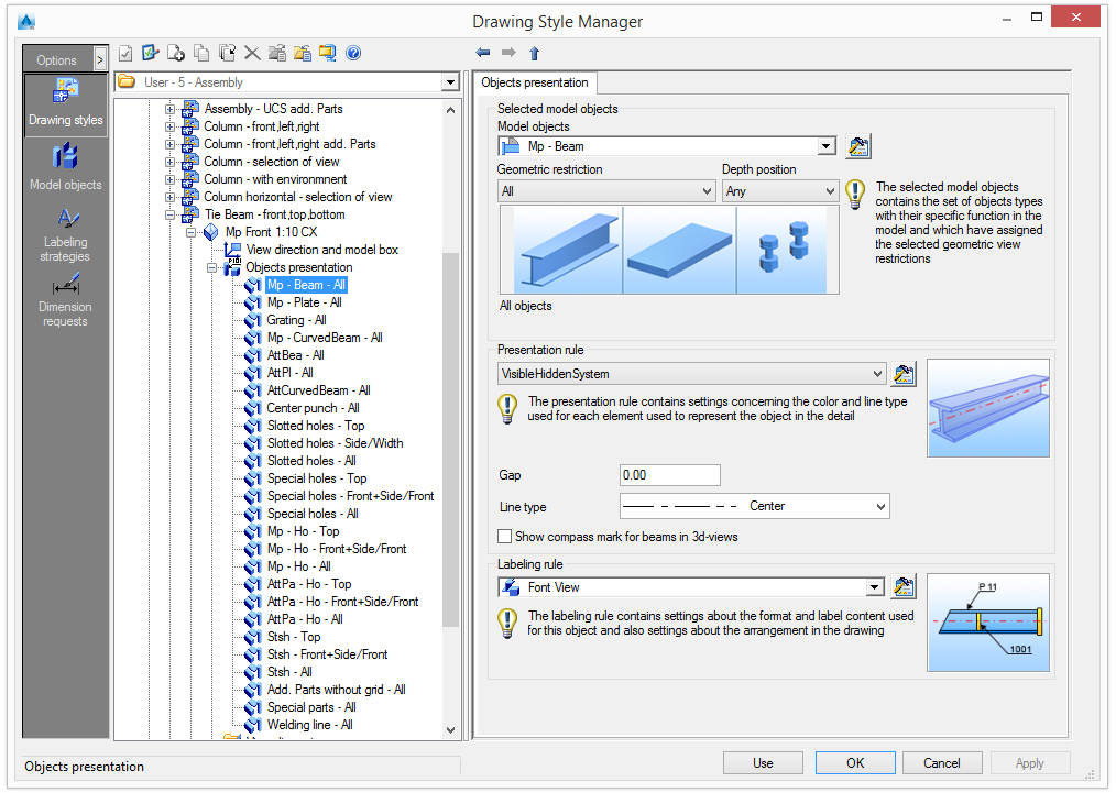

Each objects presentation rule can be modified by defining the geometric restriction, depth position, presentation rule and labeling rule.
Set the view geometric restrictions for the selected model objects
Model objects are selected in the Selected model objects area.
For details about the selected model objects, click
(Set). The model objects can be shared by different styles and can be managed separately as described in
Model Objects.
- Geometric restriction.
- Depth position.
The object presentation name is created by combining the name of the model object, the geometric restriction and the depth position.
Examples: Object presentation names.
Column - Front | The Column model object seen in detail from the front. |
AttPlatesWithHoles-All-Rear | Advance plate objects that are attached to a main part and have holes, seen in detail from any direction and are placed behind or under the main part. |

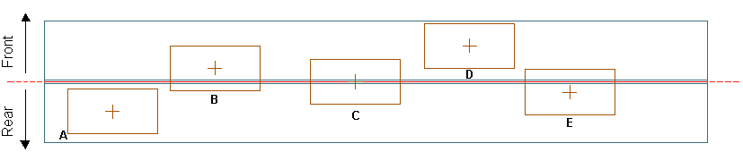

Depth position
The depth position is the "Z" position of the object relative to the main object of the detail. The following options are available:
Depth position | Description |
Any | On any side of the element. |
Both sides | On both sides (front and rear) of the main element (plates B, C, E). |
Both sides-Center | Plate C. |
Both sides-CenterFront | The attached element is on both sides (front and rear) but the center is in the front side of the main part (plate B). |
Both sides-CenterRear | The attached element is on both sides (front and rear) but the center is in the rear side of the main part (plate E). |
Front (by center) | The center of the attached element is in the front side of the main part (plates B, D). |
Front (entirely) | The entire attached element is in the front side of the main part (plate D). |
Rear (by center) | The center of the attached element is in the rear side of the main part (plates A, E). |
Rear (entirely) | The center of the attached element is on the rear side of the main part (plate A). |

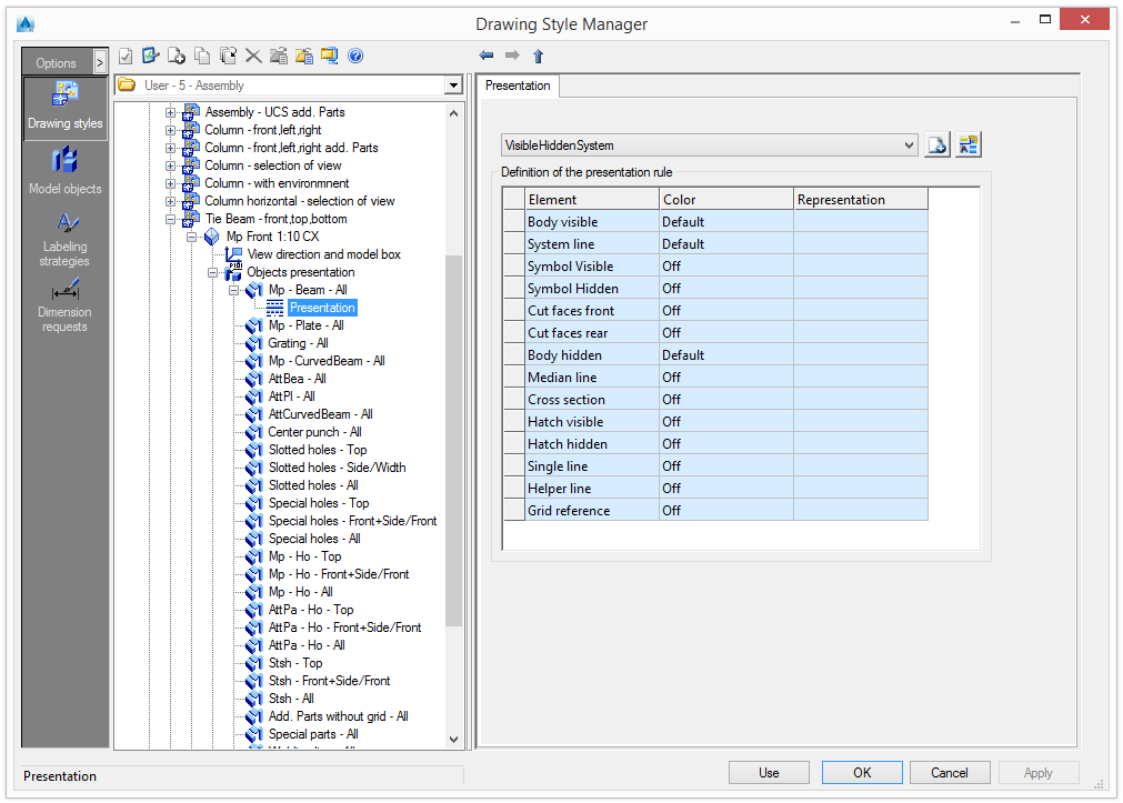

Set the presentation rule
The presentation rule contains settings for color and line type used for each object representation in the detail.
- In the Presentation rule area, select a presentation rule from the list.
- Click
(Set) to view the definition of the selected presentation rule.
Element | Representation |
Body visible | Visible solid lines. |
Axis | Only the axes are visible. |
Symbols | Symbols. |
Cut faces | Sections plane of solids with model box. |
Body hidden | Hidden lines. |
Median line | Median (center) line of the object. |
Cross section | The cross section of the object. |
Hatch | The holes are hatched. |
Simplified line | The beams are shown only with a simplified line. |
In the case of a simplified line, the line type and the gap are taken into account.
