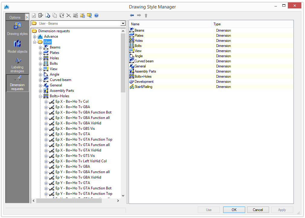

Dimension Definition Management
Select dimension requests from the component panel. The tree panel displays the dimension definitions grouped by the type of object (Beams, Plates, etc.). All the management functions are applied to the dimension definitions.
