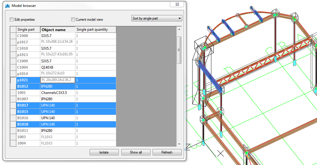

Select several elements using the Model Browser
- In the Selection tool palette,
(Model browser). The Model Browser dialog box appears.
- In the table, click the lines corresponding to the elements to be selected in the drawing area.
Note: Use Shift to select consecutive lines and Ctrl for multiple selection.
- In the drawing area the corresponding elements are selected.
Select elements based on properties using the Model Browser
- In the table, display the columns corresponding to the properties according to which you want to select the elements, for example, the Material.
- On the table header, click on the Material column.
- In the table, the lines are rearranged according to the selected property.
- Use Shift to select the lines corresponding to the desired material.
- In the model, the elements are selected.

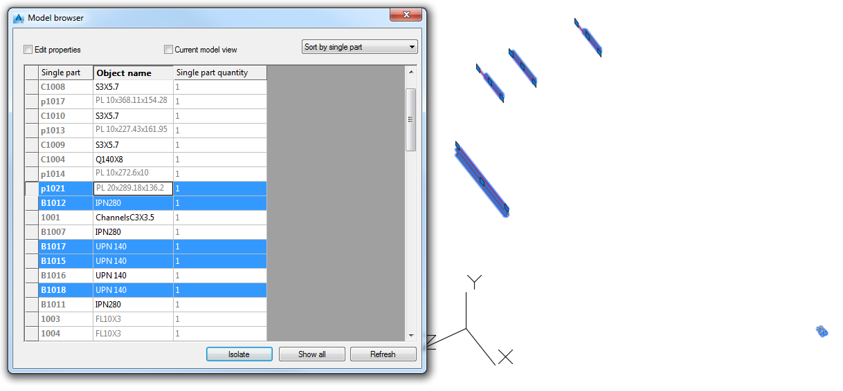

Display only selected elements
- In the table, select the elements to isolate in the drawing area.
Note: Use Shift or Ctrl for multiple selection.
- Click the Isolate button.
- In the drawing area (and in the dialog box), only the selected elements are displayed.
Note: To display all elements again, click the Show all button.
