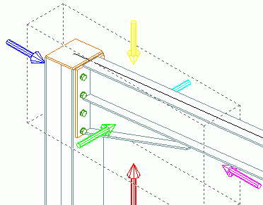

Define the View Box
After the element is selected, the symbols for the view direction are displayed. The arrow points in the Z direction. The view box size is defined by setting the view extensions in the X, Y and Z directions.
The XY plan is displayed.
