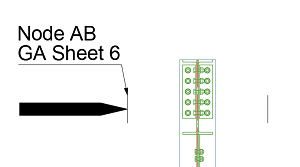

The view of the drawing is along the camera view direction, the symbol displayed on the drawing will be a small rectangle, with a fixed size (in this case, the rectangle would have to display the xy viewport, which is set to unlimited):
When the view is perpendicular on the camera view direction, the fixed depth is visible in the view, the camera symbol will be represented by two parallel lines, marking up the two boundary plans:
Limited depth and xOy viewport In this case, the symbol will appear as a rectangle or as a circle, highlighting the size of the box regardless of view direction.
Note: A fourth way to setup the model camera is limited xy viewport and unlimited depth. In this case, the camera symbol will not appear in any drawing, and the result will be like the one of an unlimited camera.

    3. Labeling: The camera symbol can automatically receive a label through the drawing style configuration. This label shows relevant information about the camera properties (description, type, viewport settings), and a reference to the drawings generated using that camera.
