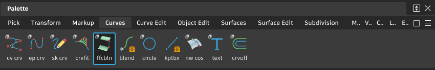

Access this tool from the Curves tool palette:

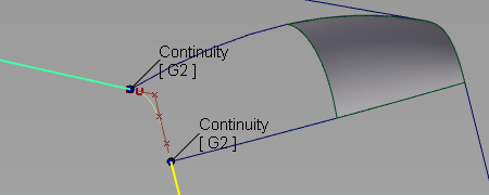

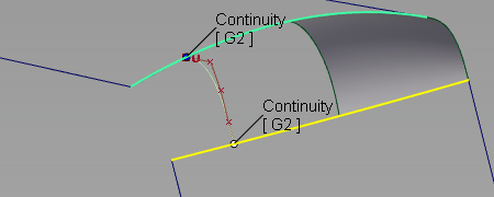

Use the Freeform Curve Blend tool to create curves that blend between curves and surface edges using the same Form Factor control used in other Alias tools (Surface Fillet, and Freeform Blend).
To create a freeform curve blend
- Shift-select the Freeform Curve Blend tool.
- Select the curve or surface edge where you want the curve blend to start.
- Drag the curve blend point to the exact location, as needed.
- Select the curve or surface edge where you want the curve blend to end.
- Set the desired Continuity and Alignment at each side of the blend, and set Blend Control options.
- Click Build.
