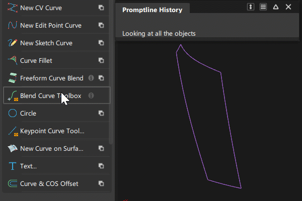

New Curve on Surface
Lets you create a curve-on-surface by drawing it manually.

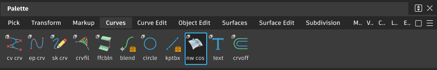

Access this tool from the Curves tool palette:
