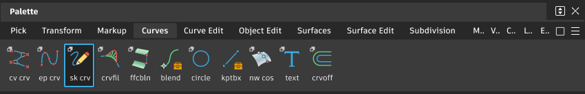

New Sketch Curve
Creates a smooth curve by drawing its shape, rather than working with edit points or CVs.
Access this tool from the Curves tool palette:
