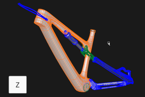

The Custom Puck is a fully customizable tool shortcut that pops up at your cursor position when you press the Z or B keys. Use the Custom Puck to access frequently used tools, editors, menu items, and navigation controls.

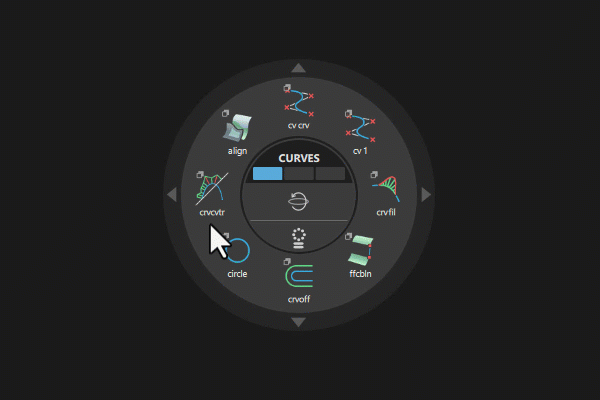

The Custom Puck is made up of a center, an inner ring, and one or more outer rings. Clicking an arrow along the circumference of the inner ring displays the outer rings. If the puck is configured with more than one outer ring, tabs display at the outer perimeter of the outer ring. Toggle between multiple outer rings by clicking the outer tabs.

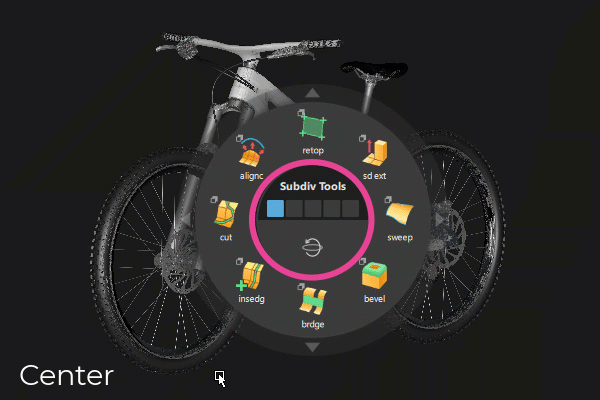

Puck center ring
By default, the puck center is divided into two sections.

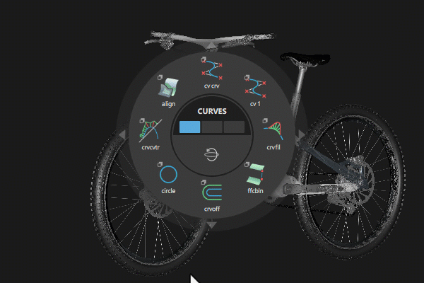

  • Click-drag the top section to switch between the inner ring menus. You can also use a mouse wheel to switch between menus.
  • Click the bottom section to access to viewport navigation controls. For example, LMB-click activates Tumble, MMB-click to Pan, and RMB-click to Zoom.
You can further divide the center of the Custom Puck into a third section that provides access to Marking Menus by using the mouse buttons. Turn this additional section on in Preferences > General Preferences > Custom Puck.

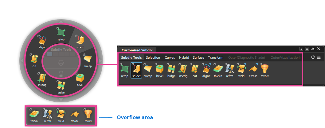

Puck inner and outer rings
Each tab in a shelf generates an inner ring menu. The tab name displays at the center of the puck when you select or scrub through the center hit-zone.
By default, inner ring menus can include up to eight items around their circumference. Any additional items are included in the inner menu display in an overflow area directly below the puck. You can increase this number to a maximum of 12 in the Custom Puck preferences.
The outer rings are accessed by clicking the arrows () along the perimeter of the inner ring. Switch between outer rings by clicking the tabs. Like the inner ring, the outer ring menus are generated by individual shelf tabs. For a shelf tab to appear as an outer ring menu, its name must begin with "Outer" followed by the tab name in parenthesis, such as "Outer(Visualization)".
Tip: Choose a combination of icons and text, only text, or only icons to display for tools in the rings by going to Preferences > General Preferences > Custom Puck > Styling.

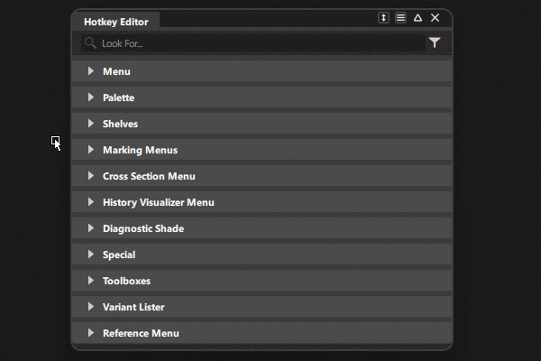

Change the Custom Puck clutch keys (Z and B)
You can specify custom clutch keys for the open and toggle open actions in the Hotkey Editor.
  1. Select Preferences > Hotkeys/Menu Editor to open the Hotkey Editor.
  2. Browse to Special > Custom Puck Functions > Custom Puck.
You can also assign hotkeys to all the tools and options in your Custom Puck.
