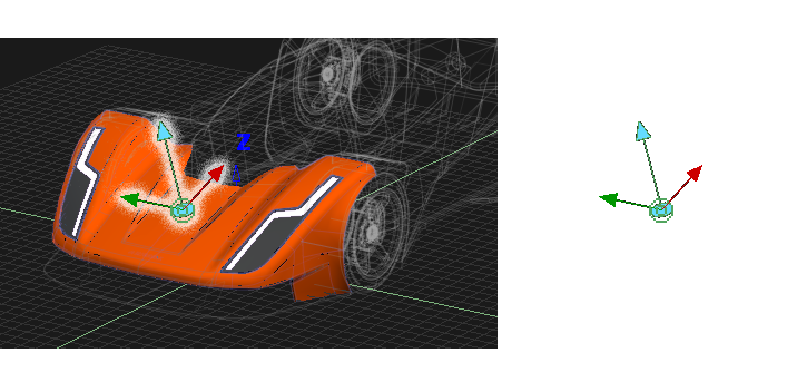

POI Manipulator and Axes
By default the POI manipulator is displayed as a small circle with NUV direction arrows.

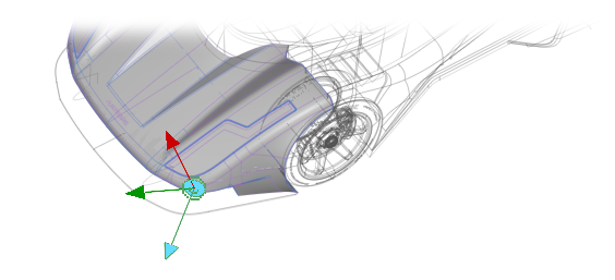

POI Position Circle
To postion the POI, hold Shift + Alt and click-release on the geometry with the left or right mouse button.
The Preferences > Selection Options settings will be respected, so if Select by Surface Interior is enabled, then either the wireframe or the surface interior can be clicked on to place the POI.
The POI can be moved across the geometry by dragging the circle at the center of the manipulator.
The color of the circle will be blue or yellow, depending on the Geometric Normal of the surface and the viewpoint.

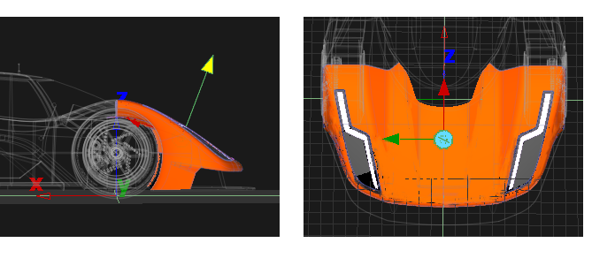

POI Direction Arrows
Clicking on one of the arrowheads will turn the view so that it looks in that direction:
Look down the normal at the point of interest location - click the light blue (or yellow) arrow on the manipulator.
Look down the U or V tangent at the point of interest - click the red (U) or green (V) arrows on the manipulator.

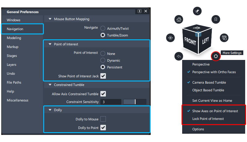

Point of Interest settings
ViewCube - More Settings menu
Show Axes on Point of Interest - When selected, a check mark appears. The point of interest is displayed as a small yellow dot without the axes displayed. This can be useful if you don't want to have the view change when you accidentally click on an axis arrow, or you want the scene to look less cluttered.
Lock Point of Interest - When selected, a check mark appears. The current point of interest is now locked. You cannot change the point of interest by dragging the manipulator or clicking geometry, until you turn off the Locked option by selecting it again.
General Preferences settings
Point of Interest
- None - There is no point of interest. Camera movements are centered around the origin of the scene.
- Dynamic - The POI is invisible and is placed with every
Shift+Alt+ left- or right-click on an object. - Persistent - The POI is visible and is placed with every
Shift+Alt+ click on an object. When this option is selected, the Show Point of Interest Jack and Dolly to Point options become available.
Show Point of Interest Jack - When this option is not selected, the POI displays only when first placed. It does not display on subsequent tumbling.
Dolly to Mouse - Check on to set the dolly-in or dolly-out point to be the mouse cursor. If not checked, the dolly-in or dolly-out point is at the center of window. If Dolly to Point is also checked, Dolly to Point takes precedence—the point of interest will be the dolly focus if it is visible in the active window.
Dolly to Point - Check on to set the dolly-in or dolly-out point to be the point of interest on screen. If checked off, the dolly point will be the mouse cursor if Dolly to Mouse is checked, or the origin if neither Dolly To Point nor Dolly To Mouse is checked.
