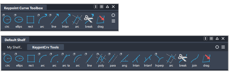

Typical uses for shelves iclude:
To have many instances of the same tools with different settings. Labels and icons can be edited to distinguish each instance.

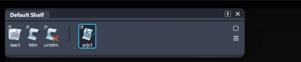

To have tools from sub-menus placed on a single level for quicker access, for example Trim and Untrim.

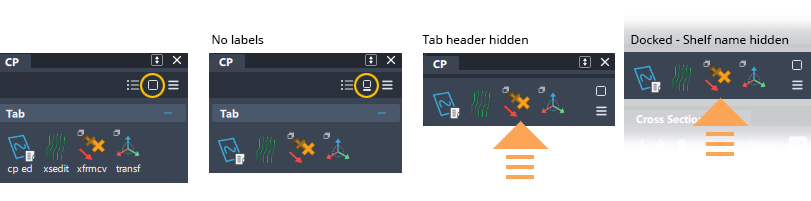

Shelf icon bar
- Select between icon and list mode.
- Choose labels on/off (in icon mode only).

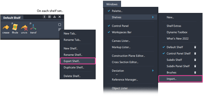

- Open the menu to select from:
- New Tab - Creates a new tab in the shelf set. A confirm box appears, displaying a default name for the new pullout. Type in a new name, then click OK.
- Rename Tab - (shortcut
Ctrl
+ double-click) Opens a rename box for the currently active tab. - New Shelf - Duplicate of Windows > Shelves > New
- Rename Shelf - Opens a rename box for the shelf set.
- Export Shelf - Saves the shelf set out to a .json format file. An exported shelf can be imported by selecting Windows > Shelves > Import.
- Duplicate Shelf - Creates a duplicate of the current shelf set.
- Delete Shelf - Deletes the shelf set.

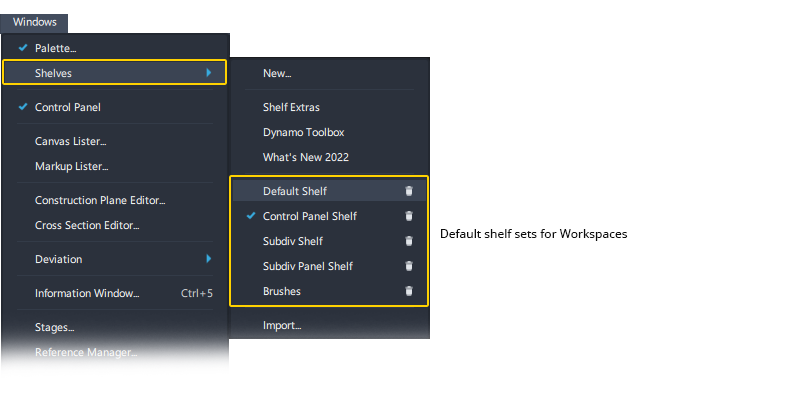

Using installed shelf sets
Some shelf sets have been provided for use in the default Workspaces. These can be accessed by selecting Windows > Shelves.
You can use any of these shelf sets and modify them to your own preferences. Ensure that you save your Preference Profiles so that your custom shelves can be restored at anytime. See Preferences > User Preferences for details on saving interface preferences to a profile.
Shelf sets that are open on the screen display a blue checkmark. This changes if you switch to a Workspace with a different shelf layout.

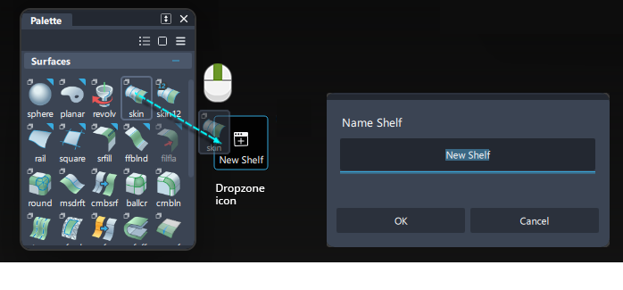

Use the MMB to drag a tool or menu item from a palette or menu.
A New Shelf dropzone appears. Release the icon when the dropzone icon boundary is highlighted in blue.
A pop-up window appears where you can enter a name for the new shelf.

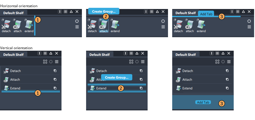

As the tool is dragged over the shelf area, one of three possible drop zones appear. These are displayed differently for horizontal and vertically oriented shelves:
Release the mouse button to place the tool:
- Tool dropzone - to the side of an existing shelf tool - places the tool at the position shown.
- Group dropzone - to the top of an existing shelf tool - adds the tool into a cascade menu. If this is the first tool added, a confirm box appears where you can name the group. Subsequent additions will just be added.
- Tab dropzone - adds the tool into a new tab. Use
Ctrl
+ double-click to rename the tab.- Horizontal orientation - between the tools and the shelf title bar and the tab names.
- Vertical orientation - in the empty space below existing tools and tabs.

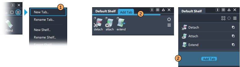

Adding tabs to shelves
You can create additional tabs in a shelf using one of the following methods:
New Tab in the shelves menu:
Drag a tool or another tab to the tab dropzone:
- Landscape orientation: a horizontal blue line appears between the tools and the shelf title bar and the tab names.
- Portrait orientation: drag to the empty space below existing tools.

For shelves where there is only one tab, the tab header is hidden (to keep the shelf compact). To expose the tab for duplicating:
- Make sure the shelf is in landscape oreientation displaying icons.
- Click-release on the thin darker line above the tool icons to display the tab temporarily.
- Use MMB drag on the tab title to move it to the destination (or
Ctrl
+ MMB drag to duplicate).

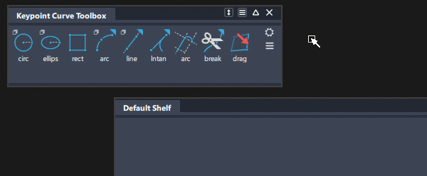

Adding Flattened Toolboxes, Palette Tabs and Menus to the shelf.
Core interface elements such as toolboxes, Palette or Menu tabs can be dragged as whole tabs to a shelf. The originals will be duplicated not deleted.
If the toolboxes or tabs contain any sub-groups, these will be flattened to a single level on the duplicated tab.
Saving Shelves
Additions and changes to a shelf are saved with the user profiles.
You can also export and import individual shelves using:
- Export Shelf on each shelf set menu.
- Import Shelf from the Windows > Shelves menu. The shelf set is opened, and added to the list in the Windows > Shelves menu. Note that the name of the shelf set is the same as it was when exported and not the filename that was used to save it.

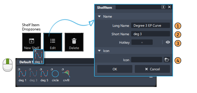

Editing shelf items
If a shelf item is dragged with the MMB outside the shelf set window, three edit icons pop up. Drag and drop the shelf tool onto an icon to:
- Create a new shelf with the selected tool added
- Edit the shelf item properties. Note that this is different than using
Shift
+ click or double-click to open the tool window and change its settings. - Delete the shelf tool from the shelf without affecting the original palette or menu tool.
In the Shelf Item edit window:
Long name: modify the name as it appears when accessed as a menu item (RMB on a shelf tab).
Short name: modify the icon label.
Add a hotkey.
Add a new icon graphic.

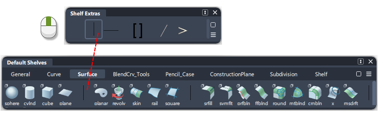

Shelf Extras - Punctuation Icons
Use Windows > Shelves > Shelf Extras to open a shelf containing spacer icons. These are six non-functioning icons that can be dragged onto the shelf using the MMB simply to help group tools and make a large shelf easier to read.
