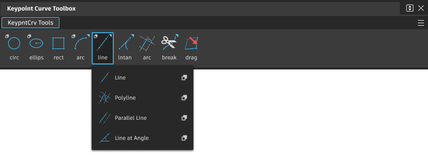

Use these tools to create a keypoint line. There are four Keypoint Curve Line tools: Line (2 Point), Polyline, Parallel Line, and Line at Angle:
Line
Creates a single keypoint line.
Polyline
Create a keypoint line composed of several segments.
Parallel Line
Creates a keypoint line parallel to another line or curve.
Line at Angle
Creates a keypoint line at an angle to another line or curve.
Access this tool from the Keypoint Curve Toolbox:
