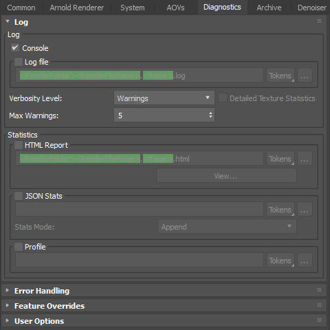

Log
Arnold can generate a log reporting all the steps needed to render an image and any warnings and errors encountered by the renderer. This log also provides detailed statistics that are useful for debugging, optimizing, and benchmarking renders.
Write Log file also found under File->Preferences, Rendering Tab, Messages group.
Log Console
Shows the log in the render message window.
Log File
Enables the output log file.
Verbosity Level
Specifies the amount of information in the render message window (needs the 'Show' flags or in the output log file.
Detailed Texture Statistics
Enable very useful per-texture statistics, with time spent on texture queries, amount of texture data read, memory consumption, etc.
Max Warnings
Limits the number of warning messages (of a similar type) that are sent to the log.
Statistics
An extensive set of tools that allows you to identify performance issues and optimize renders easily. Additional timing statistics organized by both nodes and categories can be output to HTML-based visual reports or a JSON file. This makes it possible to know which objects are most expensive to render and which parts of the renderer took the most time.
HTML Report
The Arnold Render Report is a visualization tool for reviewing charts and statistics such as frame time, memory usage, and texture stats for a rendered image. Enable HTML Report to generate an HTML file that includes all the render statistics.
View
Opens the Render Report in a web browser.
JSON Stats
Creates a JSON file with the render statistics and information that you can see in an Arnold log. If you use append mode, you get a file with the separate statistics for each render (for example, each frame in a sequence, or each pass in an IPR render).
Profile
Saves detailed profiling visualizations by outputting trace information into a file, such as "my_profile.json". You can then load the file into the Google Chrome web browser using https://ui.perfetto.dev/ or into https://www.speedscope.app/.
Profile File Path
The path of the file where the profile will be written.
Error Handling
Abort on Error
If set, rendering will stop as soon as an error is detected. This is the recommended setting. In general, you should not ignore important error messages, or you'll risk crashes, rendering artifacts, and undefined behavior.
Texture Error Color
Color used to report texture errors.
NaN Error Color
Color used to report NaNs.
