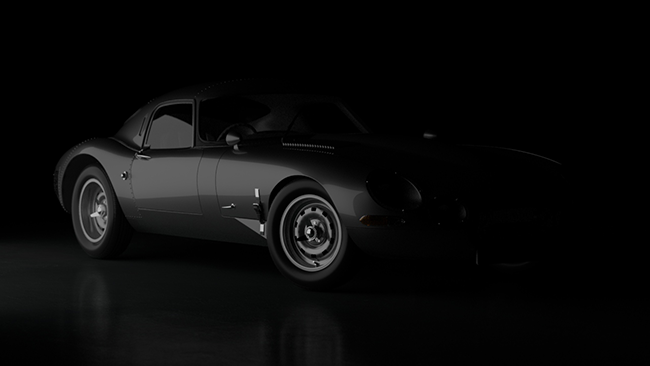

The scene is simply lit with a Quad area light representing large studio softbox lighting. A reflector has also been added to show reflections in the side of the car body.

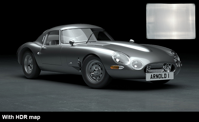

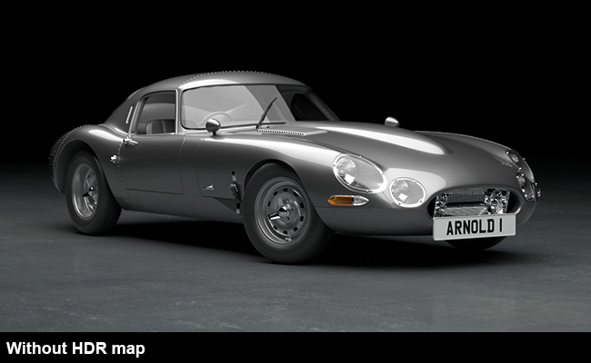

Color Texture
To get realistic, real-world color and specular reflections in the car paint and windscreen glass, it is best to add an HDR map to the color of the light. You can download the sample HDR map used in this scene here (Flat_2.hdr).
Note that the reflection (and color) of the light lacks interest without the HDR map.

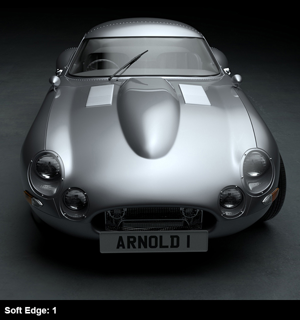

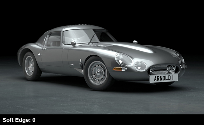

Soft Edge

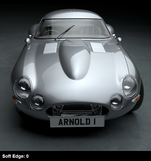

We can specify a smooth falloff for the edge of the light by using Soft Edge in the Quad Light. This creates a softer look to the specular reflections of the light in the car paint and windscreen.

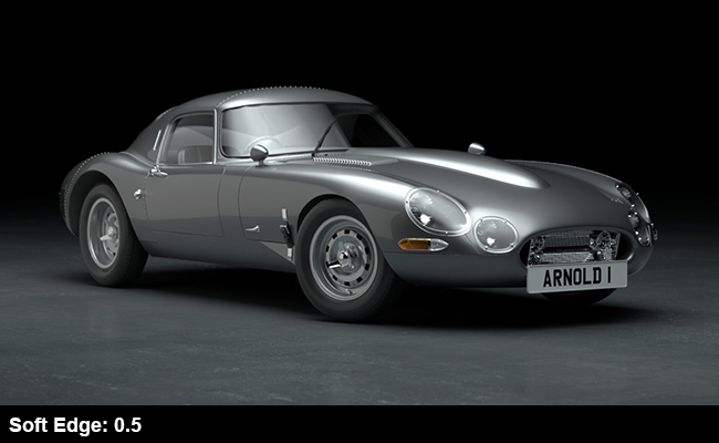

Here we can see the effect when we increase Soft Edge to 0.5 using the render camera.

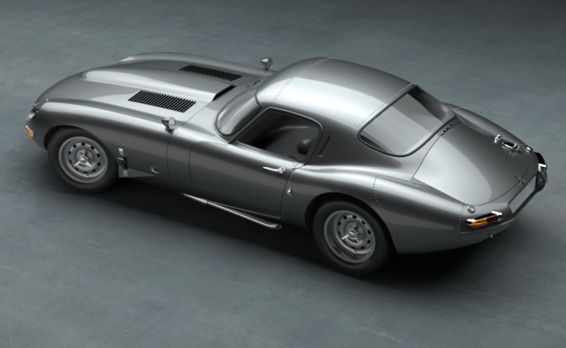

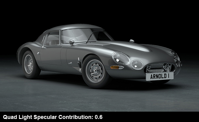

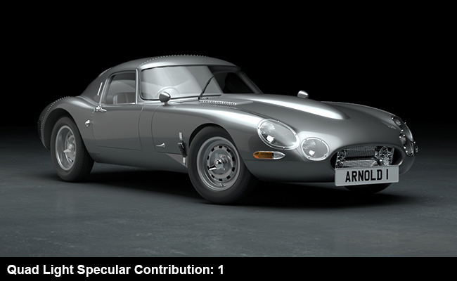

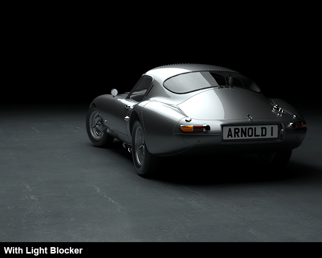

We are getting some blown highlights on the hood of the car. Reducing the Exposure of the light would help with this. However, it would also reduce the overall illumination in the scene, which is not what we want. A simpler and more effective method is to reduce the Specular contribution of the Quad Light.

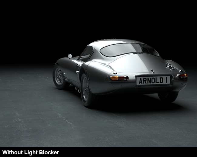

Adding a Light Blocker to the Quad Light can give you more artistic control over where and how the light is reflected in the car. Notice the effect it has on the lighting and reflections on the right side of the car.
With Light Blocker (plane).

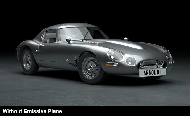

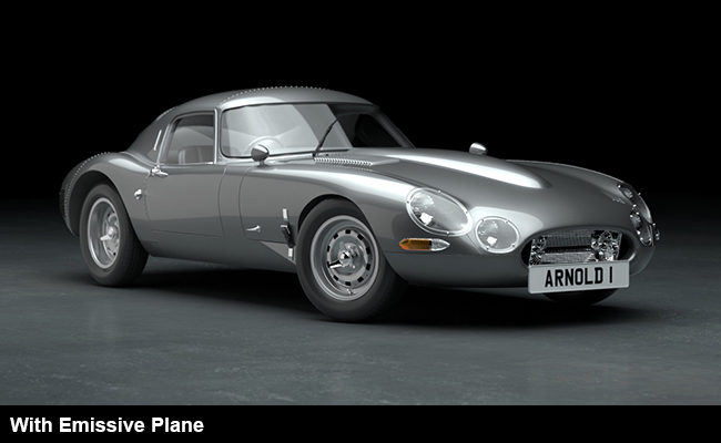

Emissive Plane
A reflective white plane has been placed to add reflection and illumination to the side of the car. This is because, typically car photographers do not normally shine lights directly onto the car, but rather shine lights onto surfaces which are reflected in the car paint. In this case, Emission Weight is 0.5. You can, of course, also map a texture to the Emission Color. However, in this case, a white Emission Color works fine.
Emissive plane (notice the effect on lighting in body and wheels).

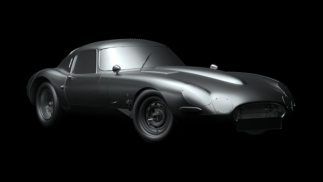

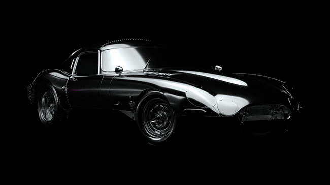

We can see exactly the effect that the emissive plane is having in the reflection of the car if we enable Ignore Lights, found under Diagnostics-> Feature Overrides.
Effect of emissive plane is more clearly visible when Ignore Lights is enabled (under Feature Overrides)

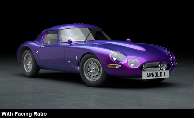

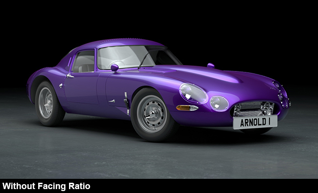

Facing Ratio Shader

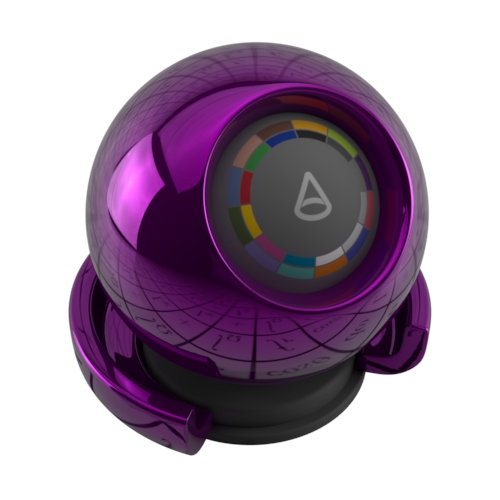

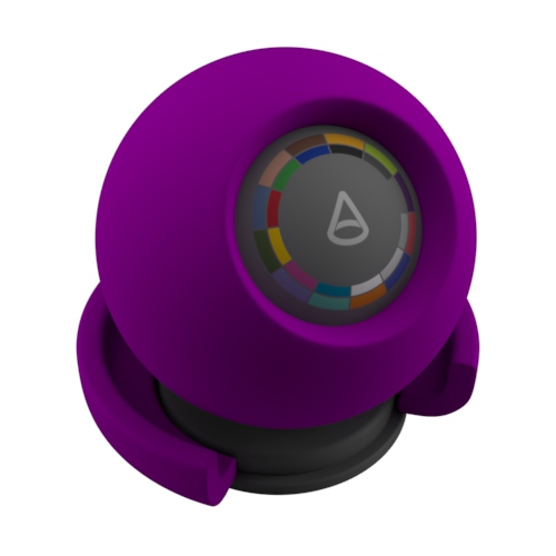

The Facing Ratio can be useful for creating a pearlescent color coating to the car paint. In the example below a Coat Color has been added to a Standard Surface shader. In this case, the Facing Ratio shader has been connected to the Coat Weight and used to exaggerate the Coat Color effect.
Base Color | Metalness | Coat Color | Facing Ratio -> Coat Weight |
With Facing Ratio | Without Facing Ratio shader. The effect is more visible in areas that are facing the camera such as the front light. |

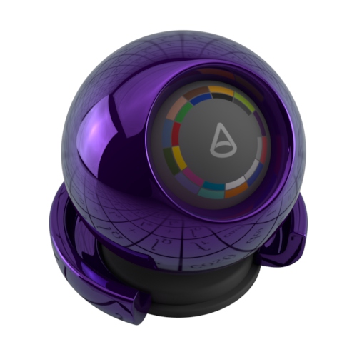

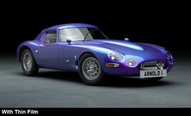

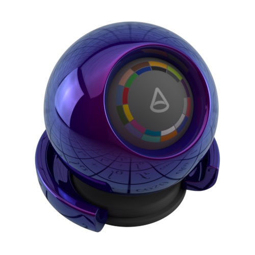

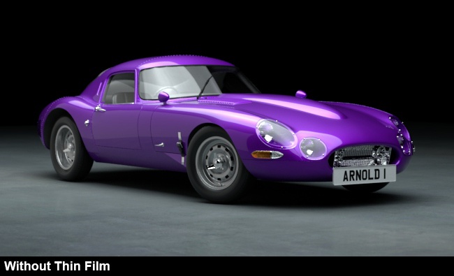

Thin Film
Thin Film in the Standard Surface shader can also be used to create a multi-tone car paint material (Thickness: 400, IOR: 1.43).

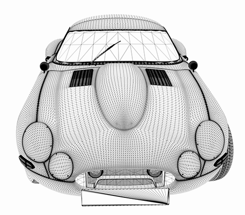

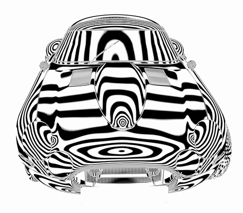

There are some shaders that can be useful for rendering car models. The Utility and Wireframe shaders can be used to diagnose contour lines and spot continuity problems when evaluating models. The Reflection Lines mode in the Utility shader can also give you an idea of how real-life reflections would behave. This sort of shading is especially useful when modeling cars where surface evaluation is critical.
Reflection Lines (Utility shader) | Wireframe shader |
