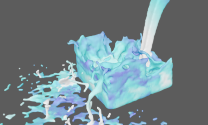

Alembic file opened in Maya
  • Scrub through the timeline in order to view the animation. In this case, the animation range is from frame 1 to 100 (the scene is from 40 to 60).

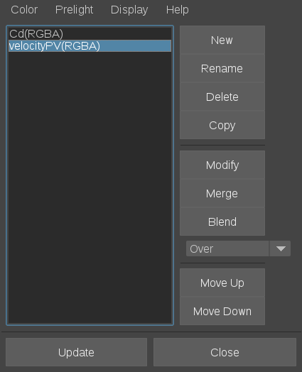

  • We can view the color per vertex data that is in the alembic. Select the mesh and go to Color>Color Set Editor and select the velocityPV(RGB) attribute.

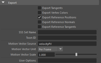

  • Select the geometry and make sure the Motion Vector Source field is set to velocityPV
  • make sure the Motion Vector Unit is set to Per Second

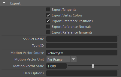

  • Finally, make sure Export Vertex Colors is enabled, otherwise, our velocityPV attribute will not be exposed to Arnold

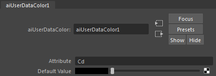

  • Create an Ai UserDataColor node and connect it to a Standard Surface shader. Assign this shader to the geometry.
  • Add Cd to Color Attr Name attribute of the aiUserDataColor node.
