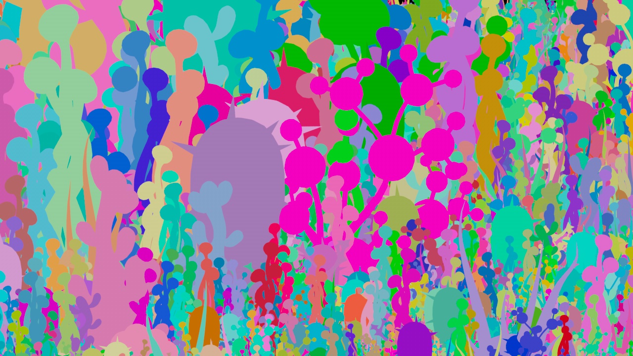

Cryptomatte is an AOV shader which encodes Cryptomatte ID mattes into EXR outputs. Usage varies by DCC. In all DCCs, however, it involves setting up a global AOV shader, though in Maya and Cinema 4D, this is done automatically. AOV shaders are shaders that run on all samples after the main shading network has evaluated. When Cryptomatte is present, and a Cryptomatte AOV is active, it will handle the rest of the setup itself inside of Arnold. The setup includes creating more outputs, writing metadata and manifests, and installing the proper filters. Cryptomatte's Filter and sidecar manifest driver are bundled in the same plugin, but should not be used manually by users.

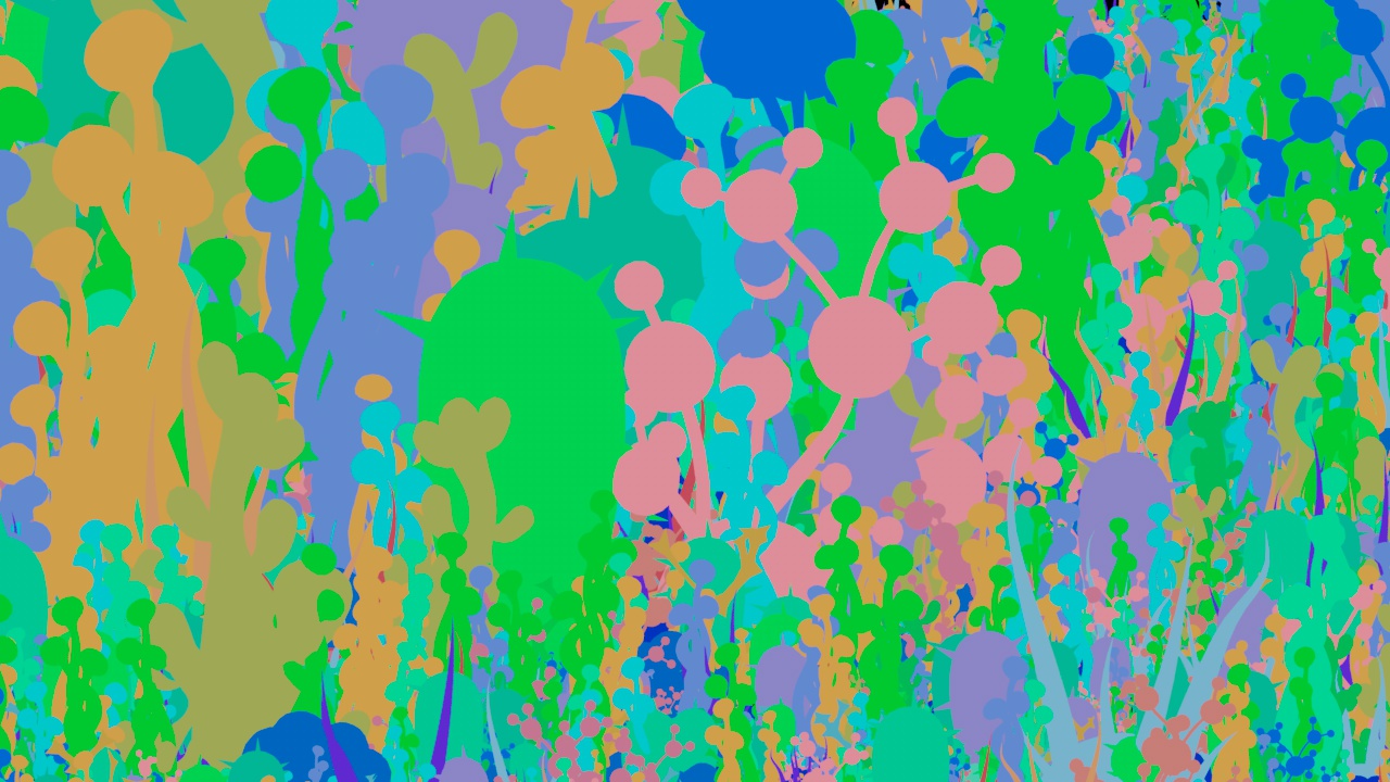

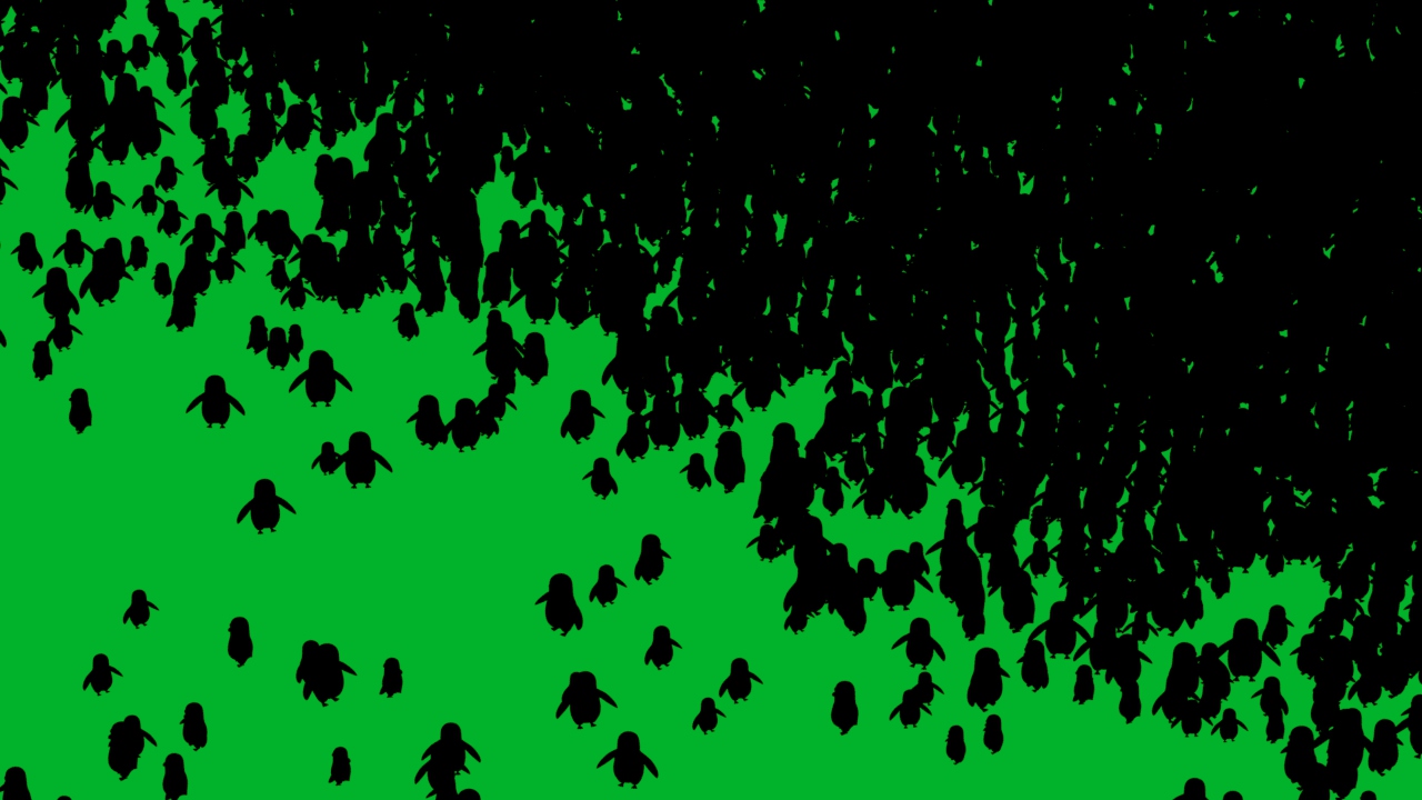

All mattes are based on names. If two objects are named "horse", either through overrides or processed names, they will both belong to the same matte. Object names and material names are used for mattes.
Asset matte might be better called "namespace". It contains, by default, information that is extracted from the object name. This is complicated because different DCCS have wildly different naming conventions, and may be mixed styles in the same scenes when sharing ass files.

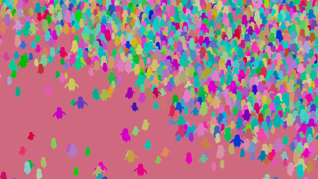

If one of these integer attributes is defined (on a shape, polygon, curve, instance, etc), it modifies the existing name. Unlike the string overrides, it only modifies the name; it does not replace it. The integer value of the user data is appended to the name. For example:
object name: helmet` `crypto_object_offset: 4` `name in cryptomatte: helmet_4

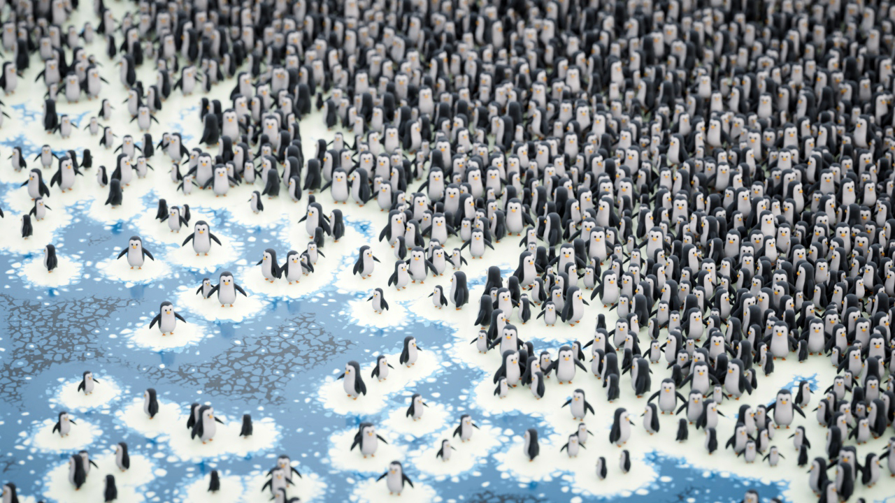

On polygons or curves, this allows selection of certain clusters of polygons as if they were separate objects. On instances, it modifies the names of all the geometry in the instances. For example, if you have instances of tanks, and you put the user data onto the instance, then one tank's thread material might be keyable as tread_material_1, and the next one might be keyable as tread_material_2.
