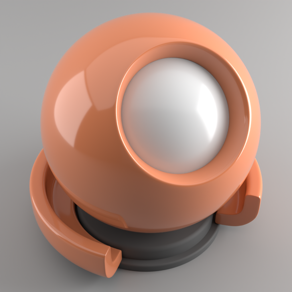

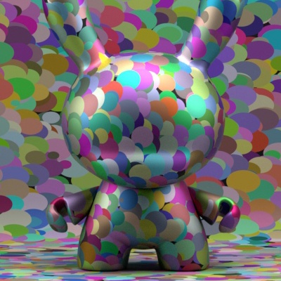

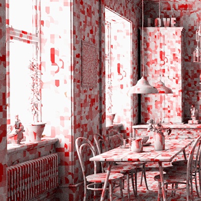

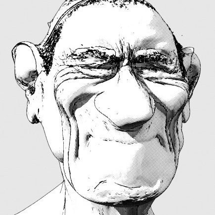

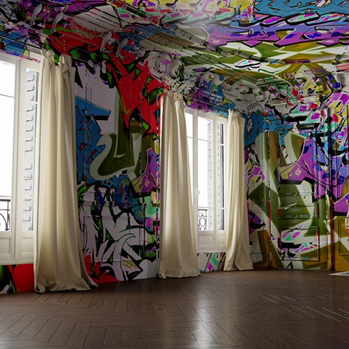

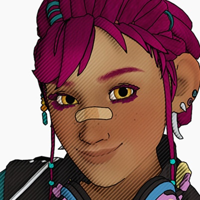

Note:
The OSL shaders used in the above examples can be found here.

A simple example of a layered shader constructed using the MaterialX closures:
shader glossy_diffuse(color base_color = color(0.8,0.4,0.2),
                      float base_diffuse_roughness = 1.0,
                      color specular_color = color(1.0, 1.0, 1.0),
                      float specular_roughness = 0.01,
                      float specular_ior = 1.5,
                      vector U = 0,
                      output closure color out = 0)
   float  rd = base_diffuse_roughness;
   color  Kd = base_color;
   float  rs = specular_roughness;
   float ior = specular_ior;
   color  Ks = specular_color;
   closure color diffuse_bsdf = oren_nayar_diffuse_bsdf(N, Kd, rd);
   closure color    coat_bsdf = dielectric_bsdf(N, U, Ks, color(0.0), rs, rs, ior, "ggx");
   out = layer(coat_bsdf, diffuse_bsdf);
Coated diffuse material created with OSL MaterialX closures.
