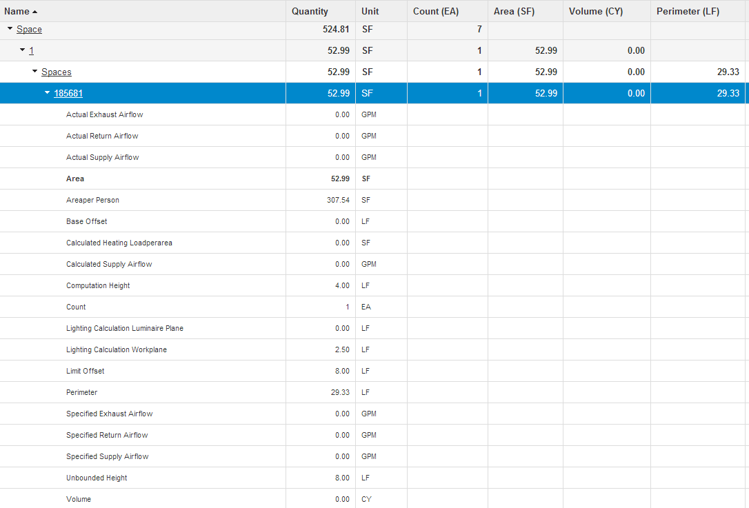

Assemble allows the user to quickly view the perimeter, square footage, and other parameters of a space from the Revit model. The data can be viewed in the default Category grouping view or the user can create a new grouping view called Spaces. To do this, click the + Create button under the Group By drop-down tool. Name the grouping order as Spaces. Then add the parameter Name and the parameter Number, and then save the grouping order.
Once the grid has refreshed, the user can scroll down to the name Space and see a numbered list of the spaces. From here, the user can expand the data further to see all of the properties for each instance of each space from the model.
