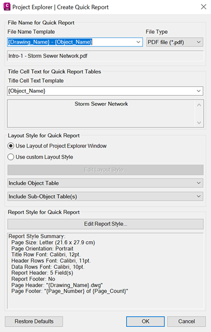

The Create Quick Report window

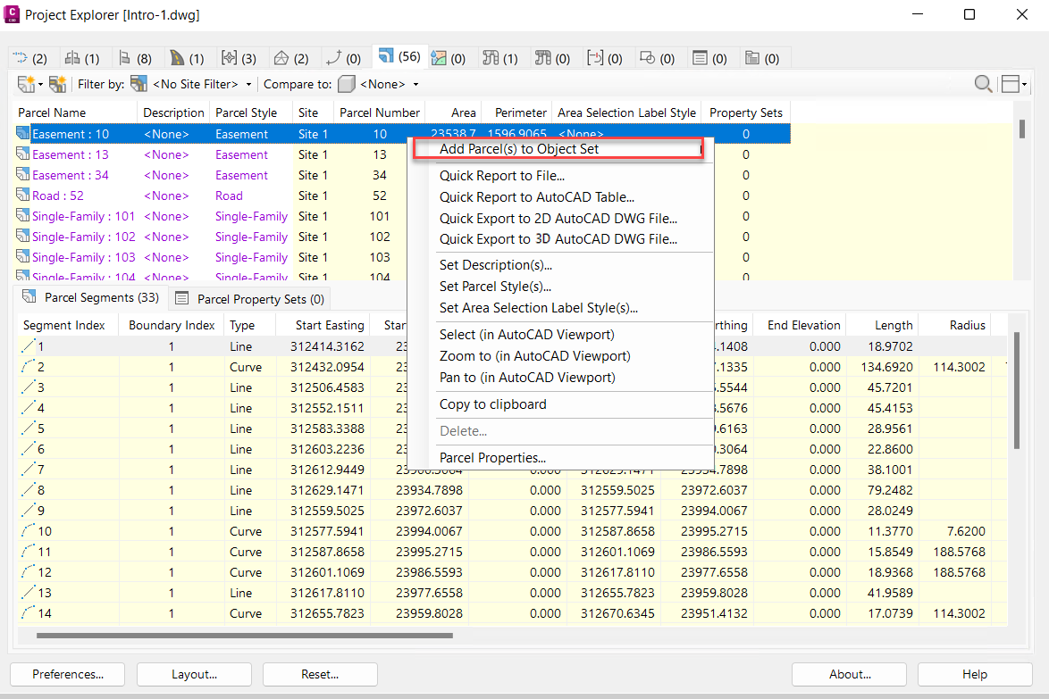

To open the Create Quick Report window, select one or more objects from any object list pane in the Project Explorer window and select one of the Quick Report to File options from the right-click menu.

File name for Quick Report
The file name for the report or spreadsheet file can either be typed in, generated from a list of standard variables, or it can be specified using a combination of the two methods. The drop-down list of variables allows all or part of the filename to be generated from a list of variables such as the selected object name, the current drawing name, the current date, user name, computer name, and AutoCAD or Project Explorer version.
When variables or combinations of variables are typed into the File Name Template field, the resulting file name is previewed in the field directly beneath it.
File type
Project Explorer supports a range of file types for outgoing reports such as TXT, PDF, CSV, HTML, DOCX, RTF, Excel XLSX, and JSON. Use this control to select the type of report or spreadsheet file that you would like to generate.
Tip: If you find the content in the JSON file is difficult to read in a text editor, try opening the file in a web browser such as Microsoft Edge.
Layout Style for Quick Report
The Layout Style for a report or spreadsheet may be specified in one of two ways:
  • Using the Layout Style currently applied to the Project Explorer window. In this instance, the layout and formatting of any content written to the report will be dependent on layout options currently in use by the Project Explorer window.
  • By defining a dedicated Layout Style for this report, or by loading a saved Layout Style definition from a file.
Click the Edit Layout Style button to define the layout, format, heading name, and visibility of data columns and values for the report or spreadsheet. The Layout Options Window opens from where a Layout Style may either by manually specified, or retrieved from a saved Layout Style file.
Include Object Table / Include Sub-Object Table
When the Create Quick Report option is used, at least two tables will be written to the report or spreadsheet by default:
  • The Object Table - this is the table which includes parameters of the enclosing object, such as an alignment, corridor, parcel, or pipe network. Select the drop-down option Include Object Table to use it.
  • The Sub-object Table - this is the table which includes parameters at sub-object level, such as alignment stations or entities, corridor feature lines and points, parcel segments, or pipe network structures and pipes. Select the drop-down option Include Sub-Object Table to use it.
With these options you can decide to suppress the creation of either the Object Table or Sub-Object Table. This is useful for situations where you might want to (for instance) create a report which includes a list of structures (which would appear in a Sub-object Table), but you do not need to see details of the pipe network (which would appear in the Object Table). If you select Include Transposed Object Table, data columns in base object table in a generated report can be formatted as rows.
Report Style for Quick Report
Click the Edit Report Style button to set the page size, page orientation, page margins, report header, page header and page footer settings for the report or spreadsheet. Use the Report Options Window to specify where a Report Style.
Note that not all settings in a Report Style definition will be compatible with every file type.
The Create Quick Report Window settings can be reset to default values at any time by clicking the Restore Defaults button in the bottom left corner of the window.
Alternative Report workflow using Object Sets
Multiple reports can be generated or updated using the Object Sets feature in Project Explorer.
To create a new Object Set which generates a report or spreadsheet, select one or more objects from any object list pane in the Project Explorer window and select Add to Object Set New Object Set from the right-click menu.
In the Create Object Set window, choose a Layout Style and Report Style and set the file name, file type and output path for the report file that you would like to generate. The report can then be generated by clicking the Run Action button in the Object Sets tab within the Project Explorer window.
