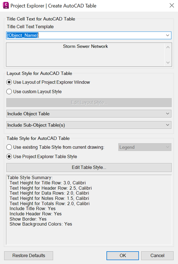

The Create AutoCAD Table window

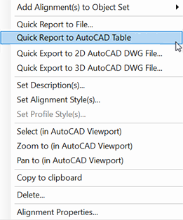

To open the Create AutoCAD Table window, select one or more objects from any object list pane in the Project Explorer window and select one of the Quick Report to AutoCAD Table options from the right-click menu.

Title cell text for AutoCAD Table
The text for the title cell of the AutoCAD table can either be typed in, generated from a list of standard variables, or a combination of the two methods. The drop-down list of variables allows all or part of the title cell text to be generated from a list of variables such as the selected object name, the current drawing name, the current date, user name, computer name, and AutoCAD or Project Explorer version.
When variables or combinations of variables are typed into the Title Cell Template field, the resulting title cell text is previewed in the field directly beneath it.
Layout Style for AutoCAD Table
The Layout Style for an AutoCAD Table may be specified in one of two ways:
  • Using the Layout Style currently applied to the Project Explorer window. In this instance, the layout and formatting of any content written to the table will be dependent on layout options currently in use by the Project Explorer window.
  • By defining a dedicated Layout Style for the table, or by loading a saved Layout Style definition from a file.
Press the Edit Layout Style button to define the layout, format, heading name, and visibility of data columns and values for the AutoCAD table. The Layout Options Window opens to specify a Layout Style.
Use Object Table / Use Sub-Object Table
When the Create AutoCAD Table option is used, at least two tables will be generated by default:
  • The Object Table - this is the table which includes parameters of the object, such as an alignment, corridor, parcel, or pipe network. Select the drop-down option Include Object Table to use it.
  • The Sub-object Table - this is the table which includes parameters at sub-object level, such as alignment stations or entities, corridor feature lines and points, parcel segments, or pipe network structures and pipes. Select the drop-down option Include Sub-Object Table to use it.
With these options you can decide to suppress the creation of either the Object Table or Sub-Object Table. This is useful for situations where you might want to create an AutoCAD table which includes a list of structures (which would appear in a Sub-object Table), but you do not need to see details of the pipe network (which would appear in the Object Table). If you select Include Transposed Object Table, data columns in base object table in a generated AutoCAD table can be formatted as rows.
Table style for AutoCAD Table
The Table Style for an AutoCAD Table may be specified in one of two ways:
  • By selecting an existing AutoCAD table style from the current drawing using the drop-down list of table styles indicated.
  • Press the Edit Table Style button to define a new AutoCAD table style from a Project Explorer table style. Use the table style defines the border color, font size and type, cell margins, and general visual style of each table. The Table Options Window opens to specify a Table Style.
Restore defaults
The Create AutoCAD Table Window settings can be reset to default values at any time by clicking the Restore Defaults button in the bottom left corner of the window.

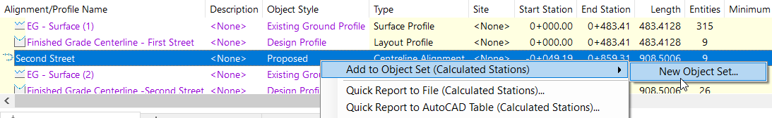

To create a new Object Set which generates one or more AutoCAD tables, select one or more objects from any object list pane in the Project Explorer window and select Add to Object Set New Object Set from the right-click menu.
In the Create Object Set window, choose a Layout Style and Table Style and set the insertion point for the table(s) that you would like to generate. Finally, choose whether the table(s) should be updated manually or dynamically. The table(s) can then be generated with a mouse click on the Run Action button in the Object Sets tab within the Project Explorer window.
