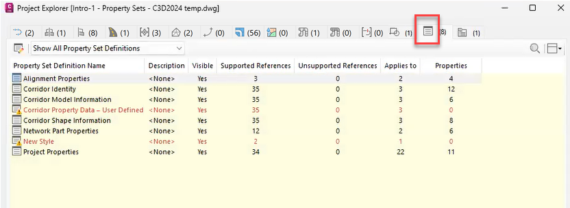

Working in the Property Sets Definitions Tab
The Property Set Definitions Name list view displays all property set definitions in the drawing. The Property Set References list displays all references associated to the property set you selected in the first list view and all properties of selected references are displayed in the list in the bottom right corner.
To add or remove a property set reference:
- Select a property set definition from the Property Sets Definitions tab. The associated property set references for the definition will displayed.

Working in the Property Sets Sub-Object Tab
In the Property Sets sub-object tab you can assign and manage property set definitions and their references, export reports, and review property sets data.
The Property Sets sub-object tab is found in any supported object tab in Project Explorer and can be displayed or hidden by clicking the Show/Hide Sub-Object Property Sets button under the Point Groups tab, Pipe Networks tab and Pressure Networks tab.
Search and filter for property sets using selected criteria. Click the Filter By drop-down menu to switch filter criteria. Use the Find function to search for a certain property set. Enter "*" or "?" to run a search.
