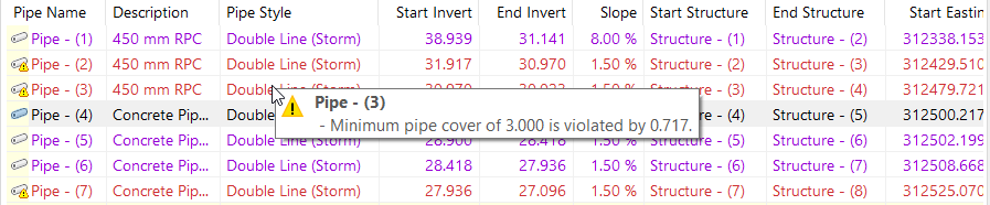

What does a violation look like?
Violations are highlighted to the user in three ways:
- The icon for the item with the violation includes a small warning symbol in the corner.
- All data columns for the item with the violation are highlighted (by default) in a bold red font. The style and color of the font for items with the violation can be adjusted by the user from the Project Explorer Preferences panel.
- When the cursor is hovered over a violated item, a tooltip is displayed which provides detailed information. The user may then choose to address the violation by applying changes to the item either from Project Explorer itself, or from Civil 3D. If such edits cause the violation to be resolved, the violation will be removed from the Project Explorer item.

Pipe Networks
- Pipe Networks: This pipe network contains no pipes or structures.
- Pipe Networks: This pipe network references a Parts List which is missing or invalid. (v4.0.2.0)
- Pipes: Minimum pipe cover of {x} is violated by {y}.
- Pipes: Maximum pipe cover of {x} is violated by {y}.
- Pipes: Minimum pipe slope of {x} is violated by {y}.
- Pipes: Maximum pipe slope of {x} is violated by {y}.
- Pipes: Minimum pipe length of {x} is violated by {y}.
- Pipes: Maximum pipe length of {x} is violated by {y}.
- Pipes: There is no structure assigned to the start of this pipe.
- Pipes: There is no structure assigned to the end of this pipe.
- Structures: There are no pipes connected to this structure.
- Structures: Maximum diameter or width of {x} for pipe(s) connected to this structure is violated by {y}.
- Structures: Maximum pipe drop of {x} across structure is violated by {y}.
- Structures: Rim elevation of {x} for this structure does not match the referenced surface elevation of {y}.
