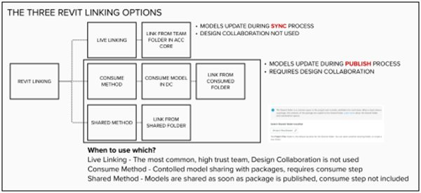

There are three options for linking Revit models:
For details, see Share Revit Models.
