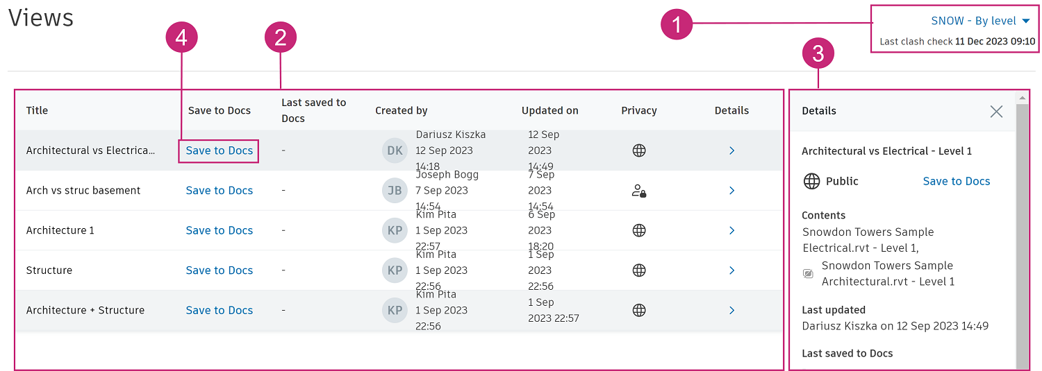

Views Navigation Basics
The Views tool displays a table of all the views created in Model Coordination. Use the Views tool to review view details, and open and manage views.
1. Coordination Space
Click the coordination space drop-down to select the desired coordination space. The views list will change to display the views from the selected coordination space.
Last clash check...: This shows the date and time of the clash check that determines the models which are displayed. Models display from the last successful clash check. If there has never been a successful clash check, all models will display from the last unsuccessful clash check.
2. Views list
Views are listed with the most recently created at the top. You can open views that you have created, or public views created by other project members.
The views list includes the following column settings:
Title: The title of the view.
Save to Docs: Click Save to Docs to create a snapshot of the view and send it to Autodesk Docs.
Last saved to Docs: If the view is saved to Docs, click the link in the Last saved to Docs column to navigate to the snapshot file in Docs.
Created by: Member who created the view.
Updated on: Date and time the view was updated.
Privacy: The icon shows where the view is public or private.
Tip: You can update the privacy settings of views to make them available to other project members, or keep them private.Details:
3. Details panel
Click in the Details column to open the Details panel. Review information including the models and 3D views contained in the view.
Scroll to the bottom of the Details panel for the following options:
- Open: Opens the view in the viewer.
- Delete: Delete your own view, or any view if you are a project administrator.
4. Save to Docs
