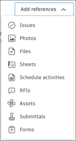

Add References to Issues
  1. Click the relevant issue in the Issues Log.
  2. Navigate to the References section in the flyout panel.
  3. Click Add references and select the relevant reference type from the references drop-down list.
    Note: If an account administrator has turned off a tool it is hidden in the selectable references. See Products and Tools for more information.
    Note: PCOs are from the Cost Management module of Autodesk® Build. If you do not have access and permission to access Cost Management, this option will be unavailable.
  4. Add a desired reference as prompted.

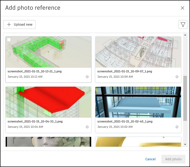

Add References to Photos
  1. Select Photos.
  2. Click the relevant photos that you want to add.
  3. Click Add photo. If you have selected multiple photos, for example 4, click Add 4 photos.
Learn about Photos here.

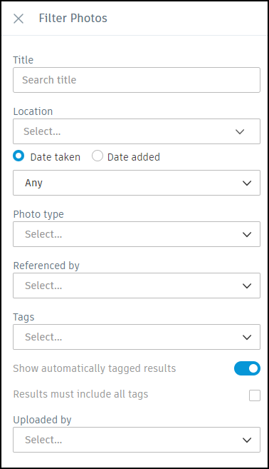

Filter Photos
  1. Click the filter icon .
  2. Select any of the following options to refine your selection:
    Note: Hide all filters by clicking the filter icon or clicking X in the Filter Photos panel. You can clear all filters by clicking the X next to the filter icon.
Upload New Photos
  1. Click Upload new.
  2. Either drag a photo to the upload area or choose a file from your local drive.
  3. Click Upload.
A reference to the uploaded photo is now added.

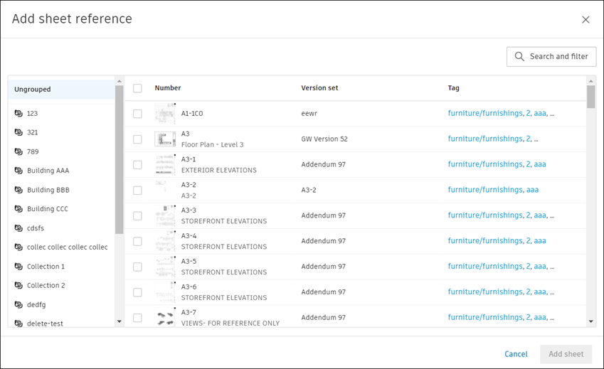

Add References to Sheets
  1. Click Sheets.
  2. Click the relevant files or use Search and filter to find desired files by name.
  3. Click Add sheets.
Learn about Sheets here.

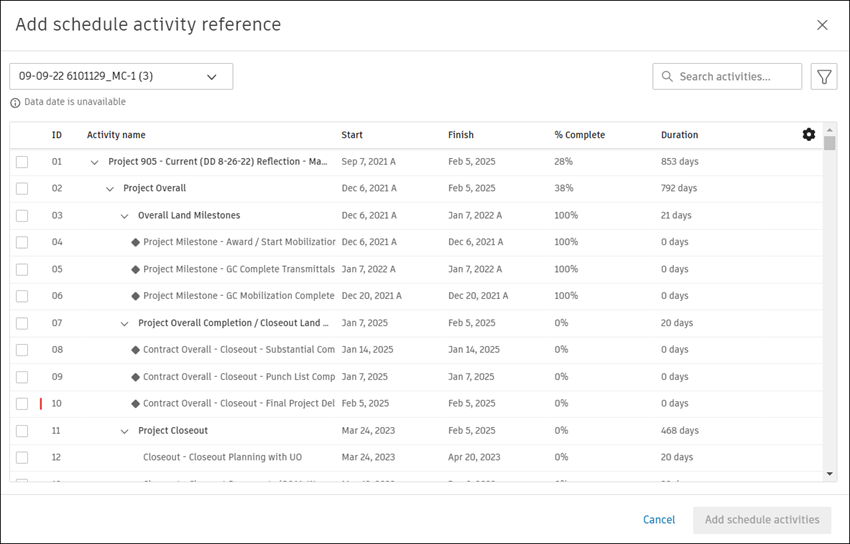

Add References to Schedule Activities
  1. Select Schedule activities.
  2. Select one or more scheduled activities.
  3. Click Add schedule activities.
Learn more about Schedule here.

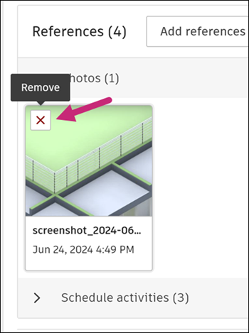

Remove References from Issues
You can easily remove any reference by following this process:
  1. Navigate to the References section in the flyout panel of the relevant issue.
  2. Hover over the reference that you want to delete.
  3. Click the icon.
  4. Click Remove.

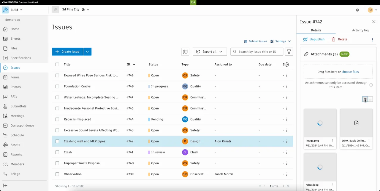

About Issue Attachments
Issue attachments are different types of files that are associated only with a specific issue, and are not visible across other ACC tools. Attachments are included in exported issue reports.
Project members with the permission to view a specific issue can view attachments associated with that issue. Issue creators and project members with Manage issues permission or above can delete issue attachments.
See Issue Permissions for more information about members' capabilities and limitations regarding attachments.
Learn how to work with attachments on your Android and iOS mobile device.
The video below shows how to work with issue attachments.
Video Thumbnail
1:16
Add Attachments to Issues
You can add attachments to existing issues or at issue creation.
  2. Navigate to the Attachments section in the flyout panel.
  3. Add relevant attachments:
    • Drag and drop desired files into the upload area
    • Browse your computer to select single or multiple files
    • Copy or grab a screenshot and paste it into the Attachments area
    • Use a camera (only on mobile)
See Supported Files Web for information about the supported file types on web.

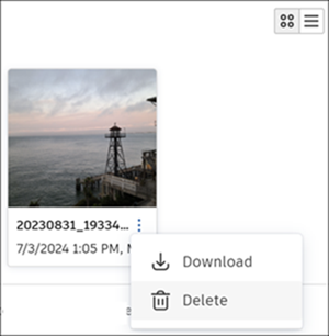

Download Attachments
  1. Navigate to the Attachments section in the flyout panel of the relevant issue.
  2. Follow these steps:
    • In the thumbnail view :
      • Click the More menu in the bottom right corner of the attachment that you want to download, and then click Download.
    • In the list view :
      • Click the Download icon on the right of the image.
    Tip: You can also download an attachment by clicking it and then clicking the Download icon in the top right of the page that opens.

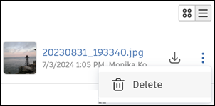

Delete Attachments
You can delete any attachment by following these steps:
      • Click the More menu in the bottom right corner of the attachment that you want to delete, and then click Delete.
      • Click the More menu on the right of the image, and then click Delete.
Tip: You can also delete an attachment by clicking it and then clicking the Trash bin icon in the top right of the page that opens.
