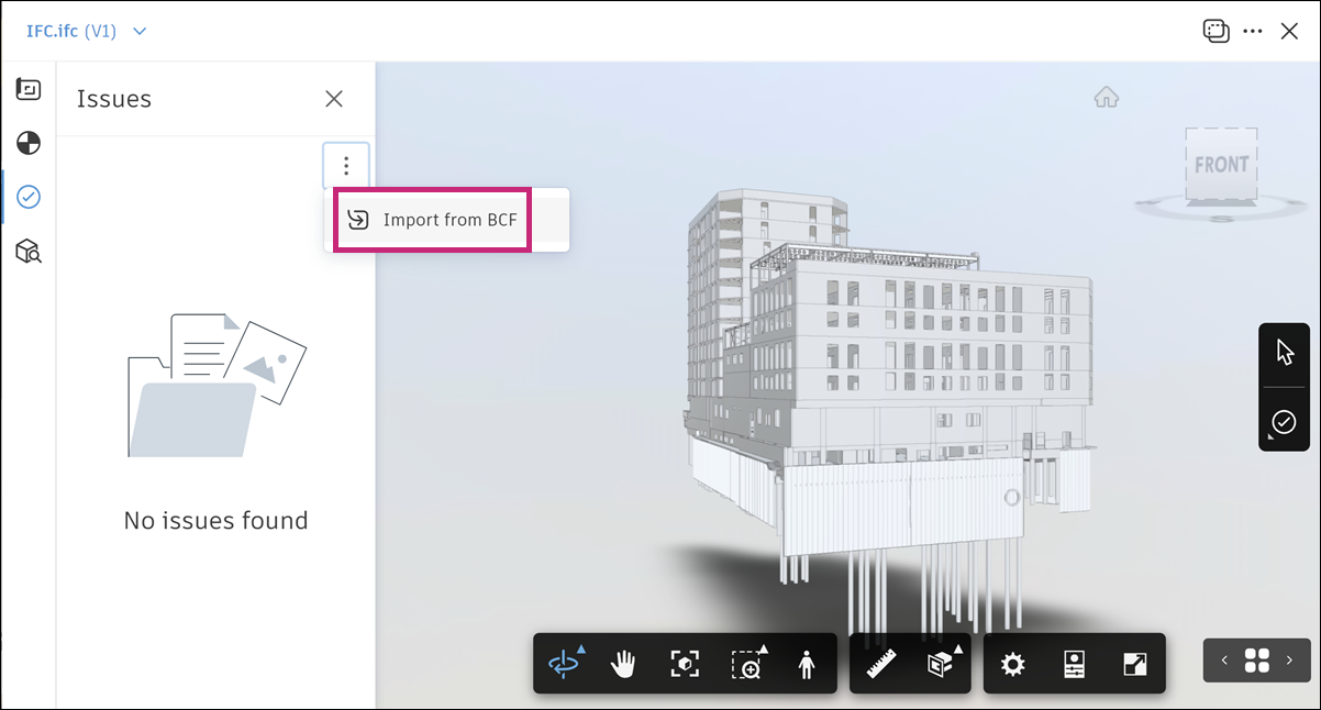

While in the viewer, you can import issues from a BCF file as follows:
  1. Click in the left navigation to open the Issues list view.
  2. Click the More menu at the top right of the Issues list and click Import from BCF.
    Import from BCF Menu Option

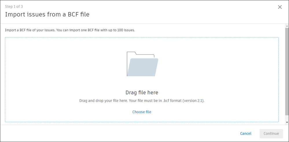

  3. Locate the zipped BCF file that matches the IFC file that you've opened in the viewer and either:
    • Drag it into the upload area.
      or
    • Add files from your computer.
      Note: A BCF file can contain a maximum of 100 issues and their associated attachments.

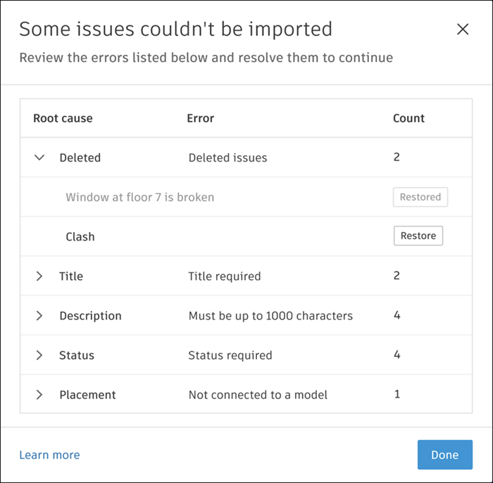

  5. In case of errors (for example, no status information), you will see the following message at the bottom left of the screen:
    • Click See why to review and resolve errors. This action opens the following modal:
    • Errors related to attachments will be included in the email notification, specifying whether some or all attachments failed to import.
    • Click Restore to restore any deleted issues. Learn more about deleting and restoring issues.
    • Click Done to proceed.

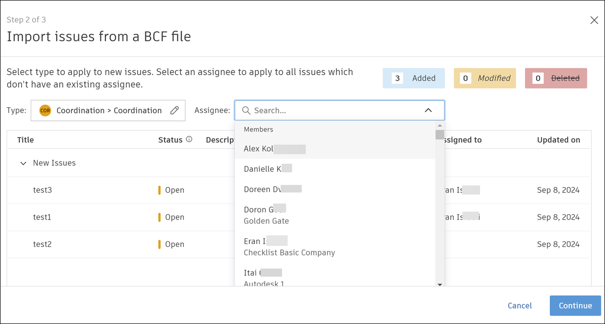

  6. On screen Step 2 of 3, use the Type drop-down list at the top left corner of the screen to assign a desired default type to new or updated issues.
    Note: On import, the status of all issues except closed ones defaults to Open.
  7. Use the Assignee drop-down list at the top left of the screen to assign a relevant member, role, or a company as a default assignee to new or updated issues.
  8. Click Continue to proceed.

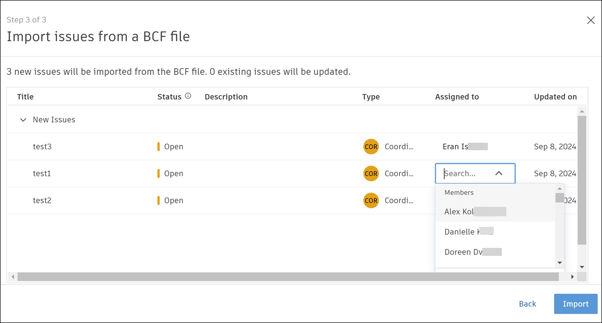

  9. On screen Step 3 of 3, review the details of the issues that you're about to import.
    Tip: You can use the in-line drop-down list to edit assignee as needed.
  10. Click Import.

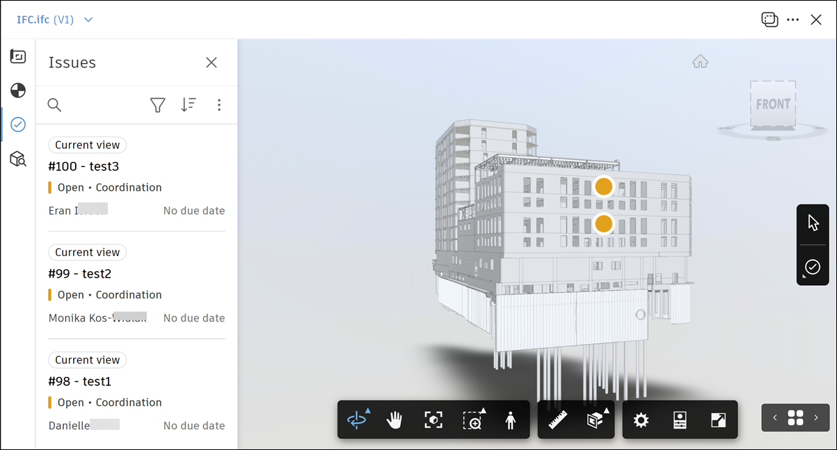

    The message in the top right corner of the screen indicates import status.
    On success, you'll see the following message appear at the top right of the screen:
    You'll also receive an email notification upon the completion of an import.
