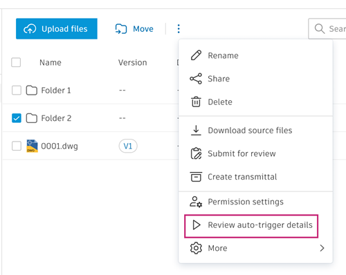

Review auto-trigger details panel:
  1. Either:
    • Click the More menu of the relevant folder in the folder tree; or
    • Right-click the relevant folder in the files list; or
    • Select the relevant folder in the files list and click the More menu in the action bar.
  2. Click Review auto-trigger details.

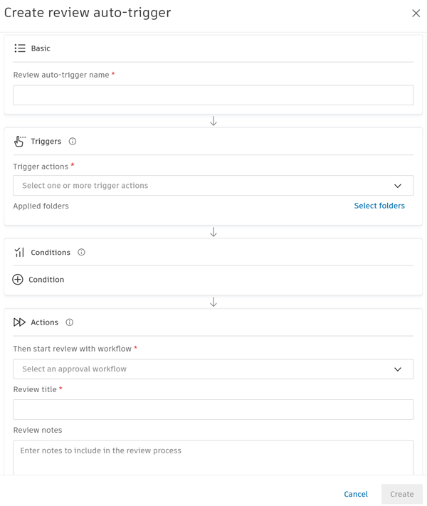

    This accesses the creation workflow which is split into four sections:
Basic
Enter a unique name for the review auto-trigger which is a maximum of 255 characters. This is a required field.
Trigger and Condition Logic

Triggers
You can select one or more file actions and file attribute trigger actions and the folders which are affected by the triggers. You can select triggers with or without conditions.
Trigger actions
Click the Trigger actions field and choose one or more of the file actions as required.

Applied folders
Click Select folders.
Note: You can select a maximum of 200 parent folders (this doesn't include subfolders).
  1. Select the folders that you want the review auto-trigger to apply to.
  2. Click Select.
    Note: This section will automatically list the selected folder if the review auto-trigger is created from the Review auto-trigger details panel.
Conditions
By default, no conditions are added. This means that any of the selected trigger actions will start a review in the selected folders.
A condition consists of three parts; an attribute, operator, and value. For example:

Actions
  1. Select the desired review approval workflow.
  2. Enter a title for the review.
  3. Enter any notes for the review as necessary.
    Note: The member who triggers the approval workflow (for example, they upload files or change attribute values to match the trigger conditions) will be the initiator of the review even if they do not have initiator permission for the selected approval workflow.

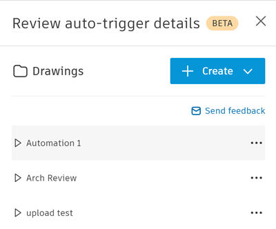

Review Auto-Trigger Details
You can select a folder from the Files tool and use Review Auto-Trigger Details to view the names of the review auto-triggers applied to that folder.
Project administrators can also create, apply, edit, remove, and delete review auto-triggers from the Review Auto-Trigger Details panel.
To access Review Auto-Trigger Details:
  1. Click the More menu of the relevant folder.
    This opens the Review Auto-Trigger Details panel:

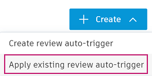

Apply existing review auto-trigger
Project administrators can apply an existing review auto-trigger to the current folder.
Note: A maximum of 100 review auto-triggers can be applied to the same folder.
  1. Click Create in the Review auto-trigger details panel
  2. Click Apply existing review auto-trigger from the drop-down list.
  3. Select an existing auto-trigger to apply to the folder.
  4. Click Apply.

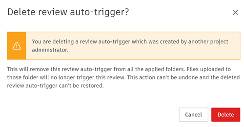

Delete
Project administrators can delete a review auto-trigger either from Review auto-triggers settings, or from the Review auto-trigger details panel.
Important: This will remove this review auto-trigger from all the applied folders. Files meeting the relevant file trigger actions to those folders will no longer trigger this review. This action can't be undone and the deleted review auto-trigger can't be restored.
