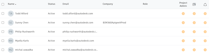

  1. In Account Admin, click the Projects tab.
  2. Choose a project from the list.
  3. For an existing member, grant project administration permissions by clicking in the Project Admin column next to their name. Granting administration permissions to the project automatically makes the person an administrator for every module that they have access to.
