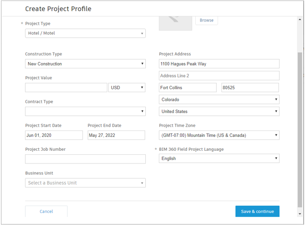

Create a Project
In the Account Admin module, click the Projects tab.
Click Add.
In the Create Project Profile dialog box, specify the project name and enter the project information. Required fields are marked with an asterisk. Some of the fields, such as the start and end dates, are used for company reporting and analytics to ensure all team members have access to consistent project information across workflows.
Select a language from the Autodesk for Government Project Language drop-down list.
Click Save & continue to create the project and display the Project Services page.
