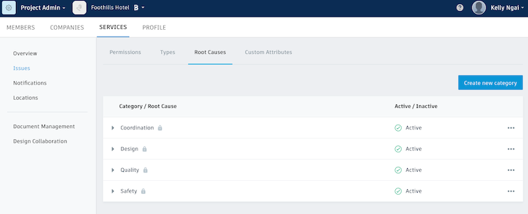

To work with categories and root causes:
Click the Module Selector
.Click the Services tab.
Click Issues in the left-side panel.
Click the Root Causes secondary tab.
Create a Custom Category
- Click Create new category in the upper right.
- Enter a category name.
Create a Custom Root Cause
- In the Category/Root Cause column, click the arrow to the left of a category to expand it.
- Click Add root cause.
- Enter a root cause name.
- Click the check mark.
