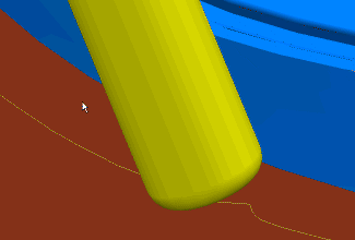

No Axial tolerance set:

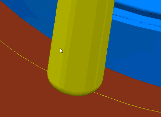

Axial tolerance set to 0.5 (mm):
