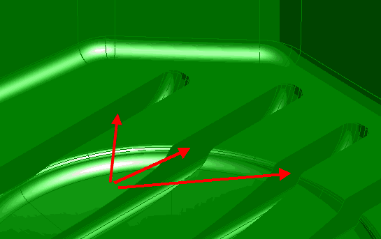

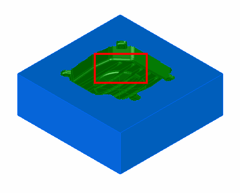

The following example has 'ribs' that contain deep cuts:

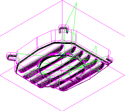

With Remove deep cuts deselected, the remachining toolpaths cut the full length of the ribs including the deep cut areas, which could damage the tool:

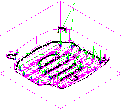

With Remove deep cuts selected, the remachining toolpaths cut only the shallower parts of the ribs:
