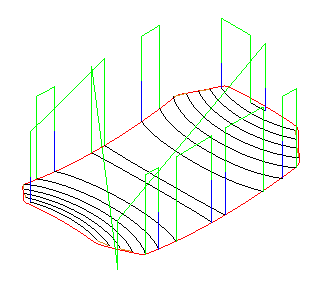

Retract options
Retract to Z rapid plane is the default retract type. The tool retracts to the full Z height:
