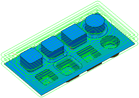

Flat surface support
LevelFeatureCAM machines whole flat Z levels.

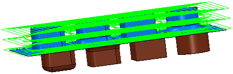

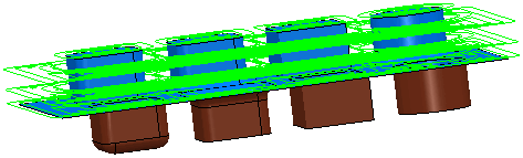

Looking at a different angle you can see that three complete levels are machined.

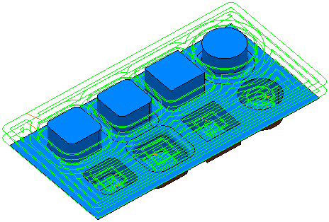

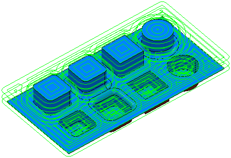

AreaFeatureCAM machines flat areas only (instead of the whole level).
Looking at a different angle you can see that only the flat areas are machined in the first level.
