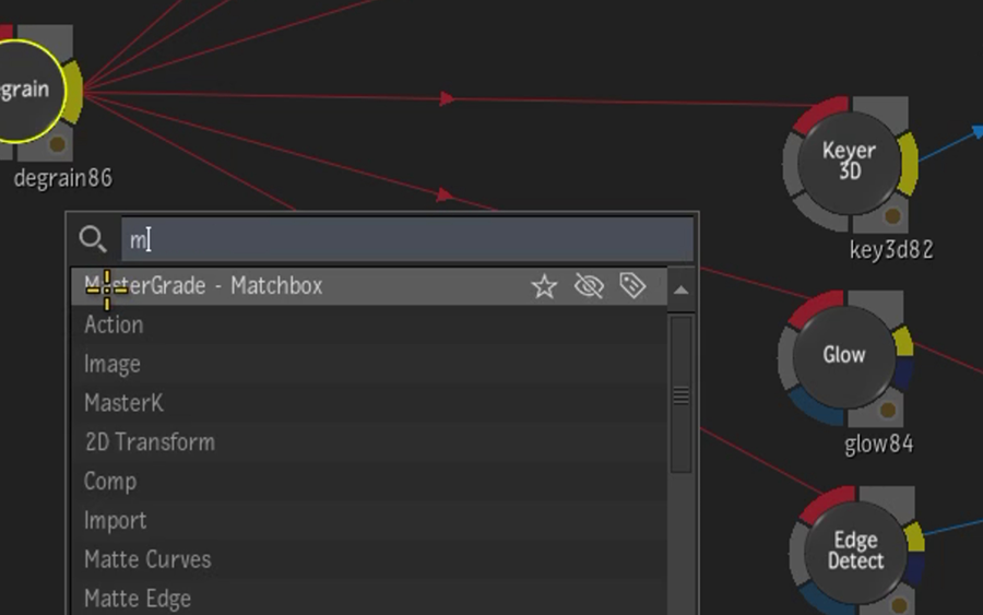

To add a node:
  1. Display Search.
  2. Start typing the name of node. Try Matte Curves.
    As you start typing, the list below displays the search results. The highlighted tool represents the current selection.
  3. To insert Matte Curves you can do one of the following:
    1. Finish spelling out Matte Curves and press Enter.
    2. Use the arrow keys to highlight the node, and then press Enter.
Tip: The nodes have also been tagged with industry terms. This means that whenever you call up Search, you can select a node using terms such as fbx or stabilizer. So you don't have to know the exact node name. Try it out!
To add a node in a specific spot of the schematic:
  1. Move the cursor to that spot.
  2. Display Search and select a node.
    The node is added under cursor.

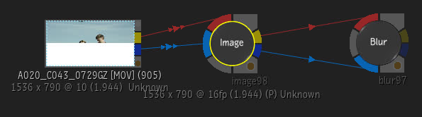

To connect to an existing node:
  1. Select the node.
    The new node is added, and connected to the first one.
    Tip: As the added node is always selected, you can quickly create a node chain by repeatedly opening Search and adding nodes.

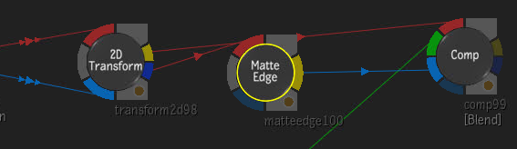

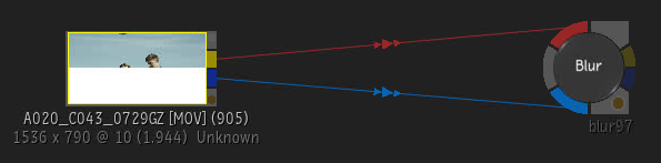

To insert a node between two nodes:
  1. Select the first node.
    The new node is inserted between the two existing nodes. The connection are preserved.
With Search, the node is always added after the currently selected node, with connections to the result outputs.

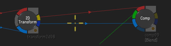

To insert a node on a connection:
  1. Move the cursor on the connection.
    The new node is inserted in the middle of the connection, between the two nodes.
Note: If the cursor is on a connection the node is always inserted within the connection, even with a node selected. If you want to connect to the selected node, make sure the cursor is not on a connection.

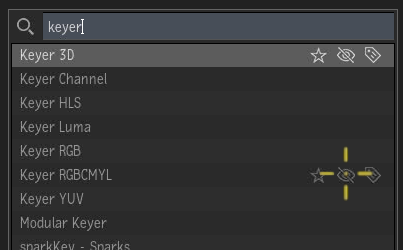

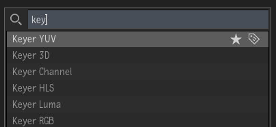

Favourite Tools
Every time you add a node with Search, Flame notices how often you use it. Search sees the tools you use and automatically displays the most used tools at the top.
So if you add the same node a few times, it starts appearing at the top of the search list. This is dynamic and will change the more you use Flame.
But you can also ensure that you favourite tools always make it to the top of Search results by making them your favourites.

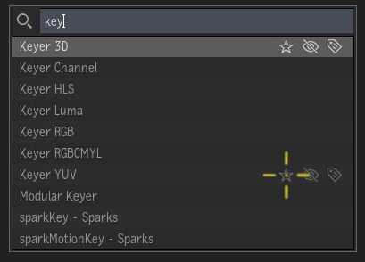

To favourite a tool:
  1. Search for the tool.
  2. Click the Star next to the tool you want to favourite.
    Next time you display Search, Keyer YUV appears at the top of the search results.
To un-favourite a tool:
  • Do one of the following:
    • Open Flame Preferences Search and remove the tool from the Favourites list.
    • Display Search and search for the tool, and then click the Star to un-favourite the tool.
You can favourite as many tools as you want.

To hide a tool from the Search results:
  2. Click the Hidden icon next to the tool.
The Keyer RGBCMYL will no longer appear in any Search results.

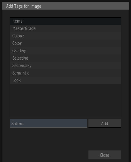

Tagging Tools
Tagging makes it easy to find the tools you need even if you don't know exactly what you are looking for. So if you want to do 3D compositing but don't know the name of the tool, open Search and type 3D... and Action appears in the results.
Same goes for a pattern generator. Open Search, type generator, and Substance Noise appears.
Flame has tools tagged with industry keywords, and these tags are displayed in Flame Preferences Search Tags.
You can add, rename, and remove tags from the Preferences. If a tool is not displayed in the Tags list, you must first add a tag from Search results.
To add a tag to a tool directly from Search:
  2. Click the Tag icon next to the tool.
  3. Add the tag to the dialog box.
    From now on, searching for Salient displays Image tool as a top result.
