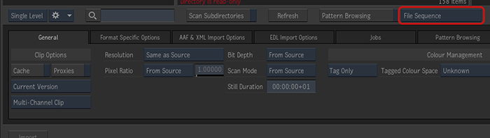

Switching Between Frame and File Sequence Display
MediaHub can display an image sequence as a single file sequence clip, or display its frames as individual images. This applies to DPX, HDR, TIFF, OpenEXR, PNG, PSD.
In previous versions of Flame Family products, you had to set this display option for each image sequence format.
In Flame Family 2022.2 Update, you now set image sequence display once for every format.
  • Frame: The image sequence is displayed as a series of individual frames.
  • File Sequence: The image sequence is displayed as a single clip.
Note: As a consequence of this change, the Sequence Detection option previously available to many Format Specific Option menus is no longer available.

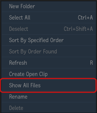

Show All Files
You can now display in MediaHub files that cannot be imported (unsupported) in Flame Family products.
  • Use the Gear menu to Show All Files and Hide Unsupported Files.
  • Selected files can be deleted when you have the write permission for these files.
