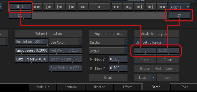

Automatic Duration for Analysis Integration
You now have two options to set the range of the Motion Vectors, Normals Maps, and Z-Depth Map Analysis Integration.
  • Custom Range: Only cache a specific range in a setup. This option was already present in previous releases.
  • Use Setup Range: Automatically adjusts the From and To fields to match the Start and End frame of the current setup. In Effects, the duration matches that of the segment.
In Batch: With Use Setup Range, From and To match Start Frame (SF) and End Frame.
