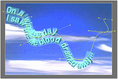

You can create a text layer on a spline and animate it over time. In this way, you create marquee text that twists and turns over an image or in time with other objects in the scene. The spline is fully editable; you can add control points and manipulate their tangent handles.

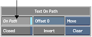

To animate text on a motion path:
  1. Create a layer or select a layer in the image window.
  2. From the Text On Path section of the Text menu, enable On Path.
    By default, the text appears on a path with three vertices.
  3. Adjust and animate the shape of the path using the Text On Path controls.

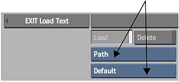

To load a raw shape data file:
  1. In the Text On Path controls, enable On Path.
  2. Click Load.
    The Text load options and file browser appear.
  3. In the file browser, select Path and then select Default from the Text Path loading boxes.
    A set of path files is visible when the Path and Default options are selected in the Load Text menu.
