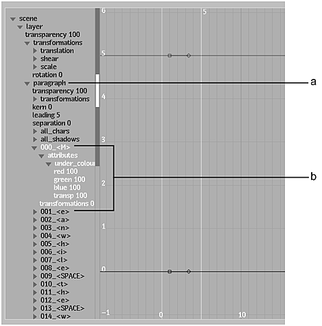

In the Text Tool, the Animation controls include a Paragraph Channel View for viewing text channels in the Channel Editor. Use the attributes and transformation channels to animate paragraphs and characters and fine-tune animations created using the Attributes menu.
(a) Paragraph folder contains all the characters, including spaces between words  (b) You can animate specific channels for each character  
To animate paragraph channels:
  1. In the Text menu, click Animation to display the Channel Editor.
  2. From the Paragraph Channel View box, select the paragraph channels you want to view in the Channel Editor.
    Select:To view:
    CurrentThe channels for the selected paragraph—the current cursor location.
    LayerThe channels for all paragraphs in the selected layer.
    AllAll channels for all paragraphs in all layers.
  3. Animate the selected channels as required.
