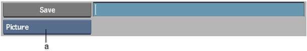

To save or load a graphic:
  1. In the Paint menu, click Load or Save.
  2. Select Geometry from the Load or Save option box.
    (a) Save option box
  3. Select a file or type in a name for the graphic.
    Note: If you are using Save and have typed in a name for the file, you must press Enter to finish saving the file.
