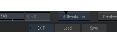

Setting the Object Resolution and Display
Use the Object Resolution box to set the resolution while drawing or editing objects. The objects are regenerated at high resolution once you release the cursor at the end of each editing operation. Use the options in the Setup menu to affect the display of the graphics before they are tacked down onto the image.
To set the object resolution:
Select an option from the Object Resolution box.
Select: To: Full Res Display the object at full resolution when updating. This is helpful for displaying gradients, but slows down the rate at which image display is refreshed. Low Res Display the object at low resolution when updating. Wireframe Display the object as a wireframe when updating.
