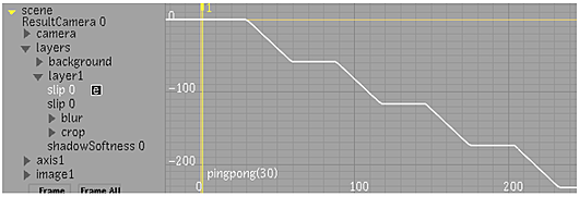

pingpong
Returns a slip value that makes a clip continuously cycle forwards and backwards. The result should usually be assigned to the slip channel of a layer.
Syntax:pingpong(length)
Arguments:
  • length is the number of frames to display before starting to play backwards. This is usually the length of the original clip.
Examples:
  • pingpong(10) returns a slip value that makes a clip continuously play in a forward and backward cycle from frame 1 to frame 10.
  • pingpong(30) yields the following curve:

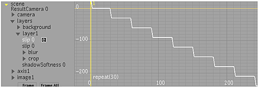

repeat
Returns a slip value that makes a clip continuously repeat forwards. The result should usually be assigned to the slip channel of a layer.
Syntax:repeat(length)
Arguments:
  • length is the number of frames to display before repeating from the beginning. This is usually the length of the original clip.
Examples:
  • repeat(10) returns a slip value that makes a clip repeat forwards from frame 1 to frame 10.
  • repeat(30) yields the following curve:

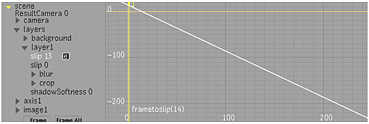

frametoslip
Returns a slip value that makes a clip display at a given timebar frame. If the given frame number is constant, the resulting clips will freeze at that frame. The result should usually be assigned to the slip channel of a layer.
Syntax:frametoslip(TimebarFrame)
Arguments:
  • TimebarFrame is the timebar frame at which to display the clip.
Examples:
  • frametoslip(10) returns a slip value that makes a clip freeze at frame 10.
  • frametoslip(frame / 2) returns a slip value that makes a clisplay at half the normal speed.
  • frametoslip(14) yields the following curve:
