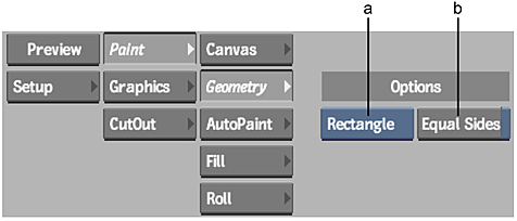

  1. Click Geometry to display the Geometry menu.
  2. Select Rectangle from the Geometry box.
    The Equal Sides button appears.
    (a) Geometry box  (b) Equal Sides button  
  3. To draw a square, enable Equal Sides or press and hold P.
