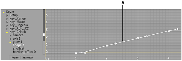

    The Shape channel appears in the Channel Editor and any Vertex channel keyframes are converted.
    (a) Shape channel with 4 keyframes  
    Note: Enabling Shape Animation disables the Vertex Keyframing and Channel Selecting boxes in the Garbage Mask Setup menu. These contain options for animating individual vertex channels. See Animating Masks Using Spline Keyframing.
